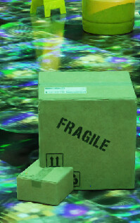

I have Enterprise Omniverse and Isaac Sim 2023.1.1 and I am using a couple of objects that when I spawn, they collide with each other plus I cannot change their texture since they don’t have the field.
My assumption is that these objects, despite being in Nucleus are not SimReady. Since when I use the certain SimReady assets from NVIDIA I don’t have collision problem and I am able to change their texture/color.

Below, is an example of unpleasant and unrealistic collision (two boxes don’t collide like that)

Hi there,
the assets you are using are probably not sim-ready (they have no collisions or physics simulation capabilities yet). You can for example quickly test them by drag and dropping them to stage and pressing play, if the assets are not falling they have no rigid-body simulation enabled. If the assets are falling, they are however not colliding with others they probably have rigid body enabled but no colliders. And if they have collisions, but are not moving, then they probably have colliders but the ribid body simulation disabled.

NOTE: even if an object is simready, if you spawn/teleport them so that they collide, they will overlap eachother, only after starting the simulateion (for at least one step) the collisions will be solved by pushing the objects out of each other. This will also apply force on the objects, so if the simulation continues to run the objects will continue to move until the force is dampened out. In this case you can pause/stop the simulation and set the velocity of the objects to 0.
