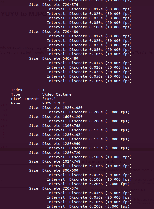

I’m using xavier NX on EN715 board, Gopro camera.
I want to use MJPG instead of YUYV format when execute Yolov3 example.
because of the frame rate.
here is the info of my camera.

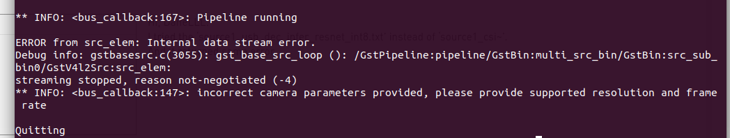

When I run the Yolov3 example, this error occur.
Don’t know why the camera parameters are incorrected.
Please give me advice.

If I set it as 480p and 30frame, It works. because it same as YUYV format parameters.
So my modification is wrong and it still use YUYV.

ERROR from src_elem: Internal data stream error.
Debug info: gstbasesrc.c(3055): gst_base_src_loop (): /GstPipeline:pipeline/GstBin:multi_src_bin/GstBin:src_sub_bin0/GstV4l2Src:src_elem:
streaming stopped, reason not-negotiated (-4)
** INFO: <bus_callback:147>: incorrect camera parameters provided, please provide supported resolution and frame rate
Quitting
App run failed

This is the full code of my deepstream_source_bin.c

This it the result.
nvidia@linux:/opt/nvidia/deepstream/deepstream-5.1/samples/configs/deepstream-app$ deepstream-app -c source1_usb_dec_infer_resnet_int8.txt
ERROR: Deserialize engine failed because file path: /opt/nvidia/deepstream/deepstream-5.1/samples/configs/deepstream-app/../../models/Primary_Detector/resnet10.caffemodel_b30_gpu0_int8.engine open error
0:00:01.379549322 15802      0x74eb0d0 WARN                 nvinfer gstnvinfer.cpp:616:gst_nvinfer_logger:<primary_gie> NvDsInferContext[UID 1]: Warning from NvDsInferContextImpl::deserializeEngineAndBackend() <nvdsinfer_context_impl.cpp:1691> [UID = 1]: deserialize engine from file :/opt/nvidia/deepstream/deepstream-5.1/samples/configs/deepstream-app/../../models/Primary_Detector/resnet10.caffemodel_b30_gpu0_int8.engine failed
0:00:01.379637899 15802      0x74eb0d0 WARN                 nvinfer gstnvinfer.cpp:616:gst_nvinfer_logger:<primary_gie> NvDsInferContext[UID 1]: Warning from NvDsInferContextImpl::generateBackendContext() <nvdsinfer_context_impl.cpp:1798> [UID = 1]: deserialize backend context from engine from file :/opt/nvidia/deepstream/deepstream-5.1/samples/configs/deepstream-app/../../models/Primary_Detector/resnet10.caffemodel_b30_gpu0_int8.engine failed, try rebuild
0:00:01.379704555 15802      0x74eb0d0 INFO                 nvinfer gstnvinfer.cpp:619:gst_nvinfer_logger:<primary_gie> NvDsInferContext[UID 1]: Info from NvDsInferContextImpl::buildModel() <nvdsinfer_context_impl.cpp:1716> [UID = 1]: Trying to create engine from model files
INFO: [TRT]: Reading Calibration Cache for calibrator: EntropyCalibration2
INFO: [TRT]: Generated calibration scales using calibration cache. Make sure that calibration cache has latest scales.
INFO: [TRT]: To regenerate calibration cache, please delete the existing one. TensorRT will generate a new calibration cache.
INFO: [TRT]:
INFO: [TRT]: --------------- Layers running on DLA:
INFO: [TRT]:
INFO: [TRT]: --------------- Layers running on GPU:
INFO: [TRT]: conv1 + activation_1/Relu, block_1a_conv_1 + activation_2/Relu, block_1a_conv_2, block_1a_conv_shortcut + add_1 + activation_3/Relu, block_2a_conv_1 + activation_4/Relu, block_2a_conv_2, block_2a_conv_shortcut + add_2 + activation_5/Relu, block_3a_conv_1 + activation_6/Relu, block_3a_conv_2, block_3a_conv_shortcut + add_3 + activation_7/Relu, block_4a_conv_1 + activation_8/Relu, block_4a_conv_2, block_4a_conv_shortcut + add_4 + activation_9/Relu, conv2d_cov, conv2d_cov/Sigmoid, conv2d_bbox,
INFO: [TRT]: Detected 1 inputs and 2 output network tensors.
ERROR: Serialize engine failed because of file path: /opt/nvidia/deepstream/deepstream-5.1/samples/models/Primary_Detector/resnet10.caffemodel_b1_gpu0_int8.engine opened error
0:00:19.417893908 15802      0x74eb0d0 WARN                 nvinfer gstnvinfer.cpp:616:gst_nvinfer_logger:<primary_gie> NvDsInferContext[UID 1]: Warning from NvDsInferContextImpl::buildModel() <nvdsinfer_context_impl.cpp:1744> [UID = 1]: failed to serialize cude engine to file: /opt/nvidia/deepstream/deepstream-5.1/samples/models/Primary_Detector/resnet10.caffemodel_b1_gpu0_int8.engine
INFO: [Implicit Engine Info]: layers num: 3
0   INPUT  kFLOAT input_1         3x368x640
1   OUTPUT kFLOAT conv2d_bbox     16x23x40
2   OUTPUT kFLOAT conv2d_cov/Sigmoid 4x23x40
0:00:19.442293898 15802      0x74eb0d0 INFO                 nvinfer gstnvinfer_impl.cpp:313:notifyLoadModelStatus:<primary_gie> [UID 1]: Load new model:/opt/nvidia/deepstream/deepstream-5.1/samples/configs/deepstream-app/config_infer_primary.txt sucessfully
Runtime commands:
	h: Print this help
	q: Quit
	p: Pause
	r: Resume
NOTE: To expand a source in the 2D tiled display and view object details, left-click on the source.
      To go back to the tiled display, right-click anywhere on the window.
**PERF:  FPS 0 (Avg)
**PERF:  0.00 (0.00)
** INFO: <bus_callback:181>: Pipeline ready
** INFO: <bus_callback:167>: Pipeline running
Quitting
App run failed
I rebuilt deepstream in /opt/nvidia/deepstream/deepstream-5.1/sources/apps/sample_apps/deepstream-app
using make clean and make all.
