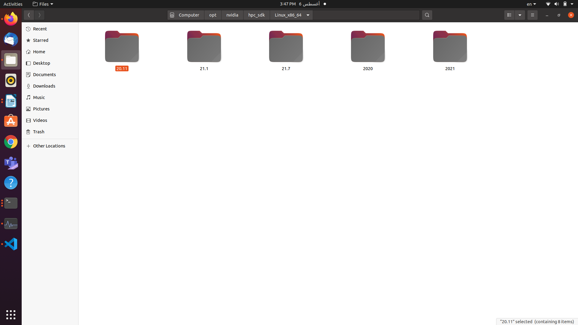

I found this folders in hpc_sdk folder
the previos folder: 2020,
20.11,
21.1
should I delete it??

You can safely uninstall the older version using sudo apt remove nvhpc-20-11 in a terminal window.
