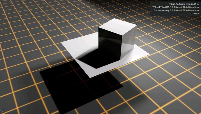

Contact points between cube and plane fully aligned
Detailed Description
How to increase the number of contact points between two rigid bodies that are fully in contact as follows:
A cube that lies on top of a plane.
For now the maximum that I’ve achieved is 6 points of contacts (some of the times it can be 4 or 5). Would want to increase the resolution of the plane to identify contacts in better resolution. Also more information about how this method of generate geometry contacts work can be helpful.

Hi @davidLe which API are you using to get contact sensor reading? Have you tried get_contact_sensor_raw_data?
Thanks for the answer.
I use the following:
Is it possible to print raw data from action graph node?
Using raw contact sensor data seems to be the right way.
Is there an option to create a grid of contact sensors over a plane?
In the example of the cube on top of a plane - is it possible to control the number of contacts per area for these touching faces?
The simulation for which I try to extract contact points between the cube and the plane:
When calling to the function get_contact_sensor_raw_data I get only 4 contact points when cube fully touches the plane.
I have also tried to use PrimView and set large number of contacts.
Then calling the function get_contact_force_data shows 4 positions and force values for the contact points, the rest of the array contains zeros.
If there is any way I can change the resolution of contact points when face fully touches the plane it can be useful.
