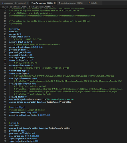

I have a multi-input model that requires two streams of images as input. I’m trying to modify NvDsInferInitializeInputLayers, but it doesn’t seem to work. How should I modify gst-nvinfer plugin and nvinfer library?
You can use our nvdspreprocess to customize your own tensor. You can refer to our deepstream-pose-classification demo.

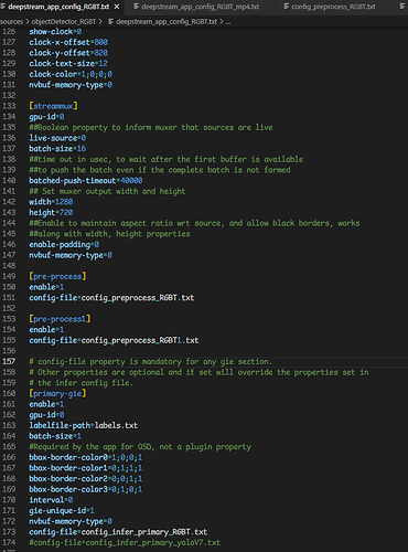

I have rewritten the nvdspreprocess_lib. How do I configure a PGIE in the deepstream-app configuration file to correspond to multiple nvdspreprocess instances? My model has two input tensors, input0 and input1. Do these two tensors require separate nvdspreprocess config files? The documentation for deepstream-app appears to provides a simple use case for nvdspreprocess.
Currently, deepstream-app does not support multiple pre-process configurations. Could you just write a simple demo, like ourdeepstream-test1, instead of the deepstream-app?

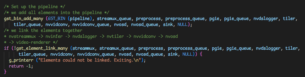

I referred to deepstream-app-test3 and created two instances of nvdspreprocess. Each nvdspreprocess prepares a tensor for an input.How do I use the gst_element_link_many function to link them in parallel to nvinfer?
They are not parallel to nvinfer, they are serial too. But you can configure the following properties src-ids for each preprocess to process data from a different source.

“I have resolved the CUDA stream bug. Here’s the current pipeline pic. Is this correct?”
Yes. The pipeline is correct.
“I modified the ONNX model to combine the two inputs into a single input with a batch size of 2, then enabled stream synchronization, and now I can directly use the deepstream-app to infer the correct results.”
