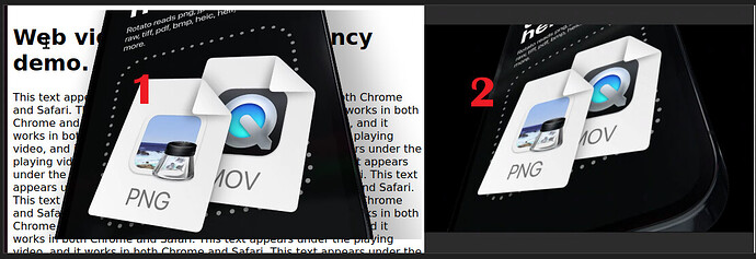

I’m trying to play a video (.webm) with transparent background but it always become black background.
I’m trying on ubuntu 22.04 and gstreamer 1.20.3 on Jetson orin nx with Jetpack 6.2.x
command is gst-launch-1.0 uridecodebin uri=file:///home/nvidia/Videos/test.webm ! decodebin ! nvvidconv ! video/x-raw ! gtksink name=gtksink ignore-alpha=0

Thanks @DaneLLL ,
Your suggest is work, but I want transparent background of video , I think nvvidconv is not support convert alpha channel. you can see at 1 is transparent support, but 2 is black in image below
Transparent background is not support so it is possible it is not shown as expected on Ori NX. Please try with common video files.
