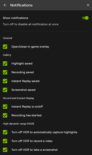

Hi there @vukodlak_666 and @nafonso. The thread was closed, but for what it’s worth, TIL that you can actually already disable the Overlay notification from popping up.
Use the settings in the NVIDIA overlay itself (the one that comes up by pressing ALT-Z on default; not the settings in the NVIDIA app), see the first picture
Here you have pretty detailed notification settings that you can adjust.
Granted, this is independent from the app recognition, but it is a valid work around I think.
