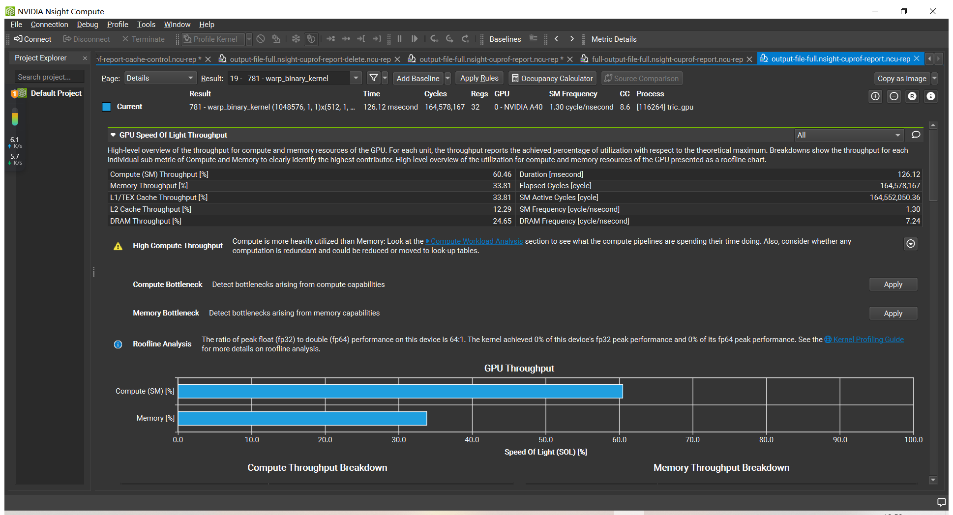

Do you have this dropdown in your report ?
Really grateful for your help!! I tried this and it works:
/usr/local/cuda-11.7/bin/ncu --set roofline --replay-mode application --app-replay-match grid --app-replay-buffer file -f --export output-file-full.nsight-cuprof-report ./tric_gpu -f /home/zyhuang/tri-GPU/accelerating-TC-main/merged_final.bin debug
But again, several rooflines does not even show one point! Strange! I am using uint32_t to compute and I guess it shoud be double… but nothing shows here…
Would you help me to check it? Thank you!!
