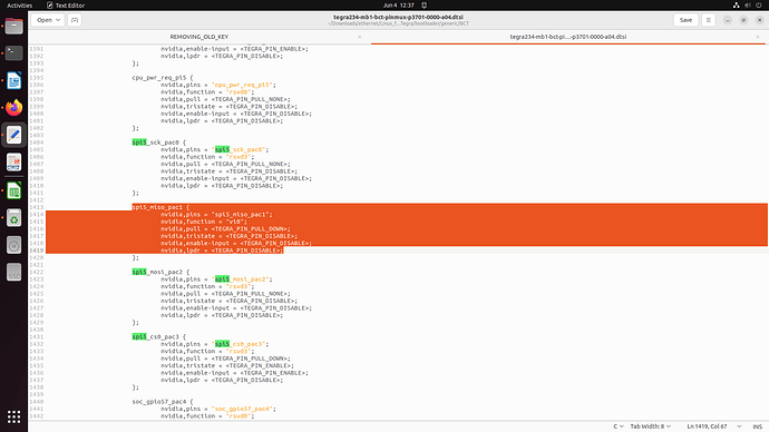

Once look into this, I am trying to gpiochip0 139 to high but unable. How can I do this.
in dts file also I have pull down the pull up.

If you saw “Device or resource busy” error when you try to access a GPIO, it means this pin is already occupied by another driver. Figure out which driver is using that first and disable it. /sys/kernel/debug/gpio might help answer that.
Otherwise you won’t be able to use that pin.
This one it is…
Yes, PAC01 is already occupied that camera-control-outpu thing so you cannot control by yourself.
So, can I change in dts file and disable it?
Yes, you could.
