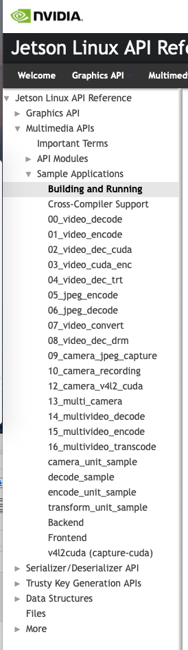

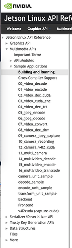

Hi Jerry.
Which sample app are you referring to?
In the Jetson Linux API, in the Sample Applications directory there are two sample apps that might be appropriate:
09_camera_jpeg_capture
10_camera_recording
neither of these contain the string “WBGains” in the main.cpp
“WBGains” is found in /usr/src/jetson_multimedia_api/argus/samples/userAutoWhiteBalance/main.cpp, as I mentioned above.
Both 09_camera_jpeg_capture and 10_camera_recording include the declaration: "include <Argus/Argus.h>
So I need to revise “WBGains: r: %0.3f gO:%0.3f gE:: %0.3f b:%0.3f\n”, in argus/samples/userAutoWhiteBalance/main.cpp and then build and run (e.g) 10_camera_recording , don’t I?
Please confirm or advise
