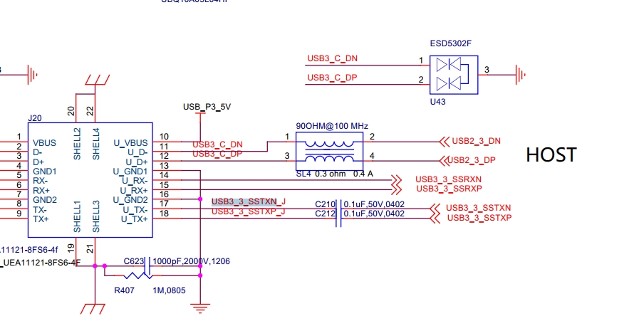

How to setup USB3.2 for AGX Orin at R35
I set ODMDATA=“gbe-uphy-config-0,hsstp-lane-map-3,nvhs-uphy-config-0,hsio-uphy-config-16”;
use USB3.2 Lane 2 which the port is map USB2-3。
my pinmux set :

微信截图_20240227105418
system log,I need help, thanks
log.txt (82.8 KB)
Please refer to
https://docs.nvidia.com/jetson/archives/r35.5.0/DeveloperGuide/HR/JetsonModuleAdaptationAndBringUp/JetsonAgxOrinSeries.html?highlight=adaptation#porting-the-universal-serial-bus
Although the problem has been resolved,But I don’t know the principle。
I replaced the/boot/dtb/xx. dtb file, it doesn’t work,It only works when I redeploy the system(./flash xxxx mmcblk-p1)
