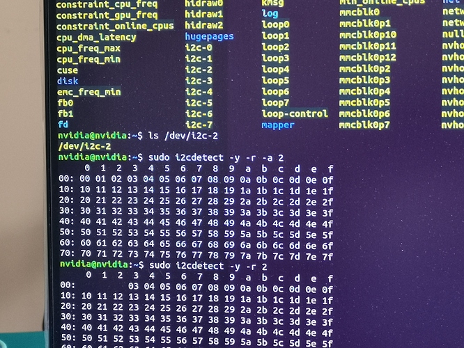

Hi,I’m tring to create a connection between Jetson Nano and ICN6211 chip by i2c.When I was using i2c-
tools to see the address of the ICN6211 by running “sudo i2cdetect -y 2” command,it scans all different
addresses and when it gets to the slave address,it cannot be writed or read.
I have pull-up resistors on SDA and SCl,but it didn’help.
I guess Jetson I2C device load error,but I don’t konw what happens that it’s not able to detect the slave
device.
