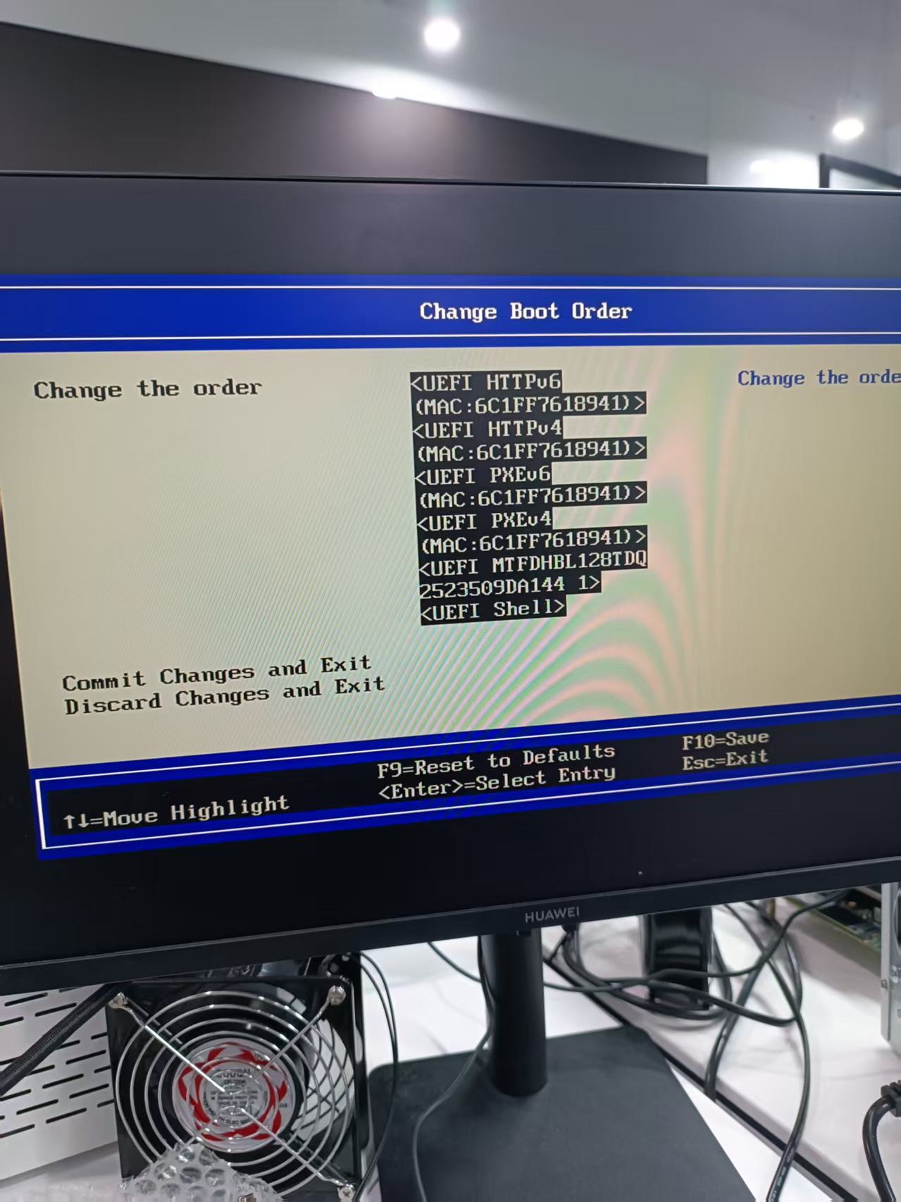

我们插入usb网卡(可插拔的usb网卡)后,httpv6,httpv4,pexv6,pexev4就会自动调到最高优先级启动系统,如何在烧录时候就禁止该4个选项,使其即使插入usb网口,也能默认从nvme硬盘启动?
由于usb网口是可随意插拔的,即使通过uefi菜单调整顺序后,拔掉usb网卡,然后再插入usb网卡,httpv6,httpv4,pxev6,pxev4,又会默认调到最高级别

I have tried the method mentioned above. With the USB network card plugged in all the time, the flashing process can set the default boot from NVMe. However, since the USB network card can be plugged in or out freely, after unplugging and re-plugging it, the USB network card boot option will be moved to the top of the UEFI menu again. Therefore, is there a way to disable the recognition of the USB network card in UEFI while enabling it in the system? Or is it possible to directly disable network boot in UEFI?

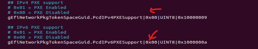

You may need to build your own uefi with GitHub - NVIDIA/edk2-nvidia: NVIDIA EDK2 platform support . It is not funny that prepending ADDITIONAL_DTB_OVERLAY=“BootOrderNvme.dtbo” failed.

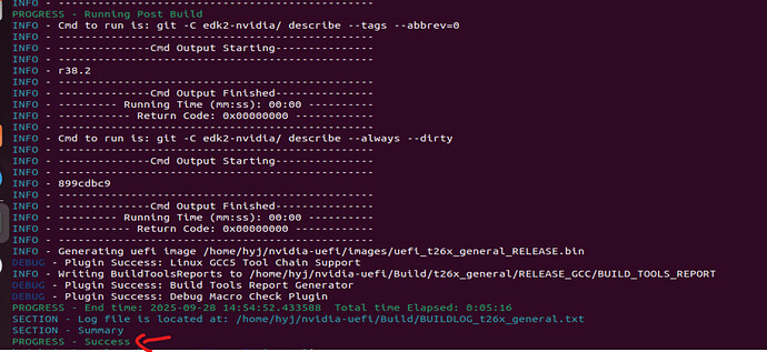

Thank you for your reply! I have successfully compiled the UEFI using the reference document (via the non-Docker method), but how can I replace the files in Linux_for_tegra?
The operation process basically refers to the following link.The configuration of t26x was used.
Compilation Reference Link: https://github.com/NVIDIA/edk2-nvidia/wiki/Build-without-docker

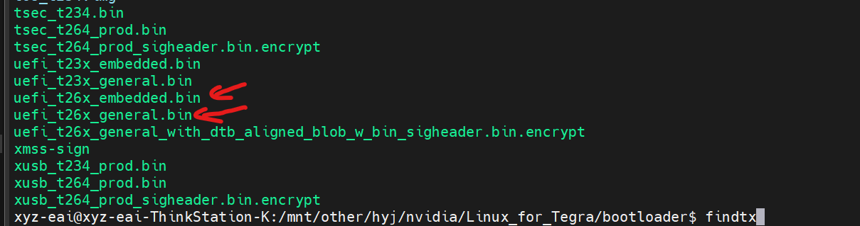

I noticed that there are two files in the bootloader
directory under Linux_for_Tegra
: uefi_t26x_embedded.bin
and uefi_t26x_general.bin
should be at ~/nvidia-uefi/images/uefi_t26x_general_RELEASE.bin
I just shut down my x86 workstation and thor. but it goes somewhere under Linux_for_Tegra
I tried 22.04 and 24.04 docker images and that failed. I’ll try not docker tomorrow.
this the branch I checked out that is supposed to contain updates post 38.2.0
git clone https://github.com/NVIDIA/edk2-nvidia.git
git switch -c r38.2-updates --track origin/r38.2-updates

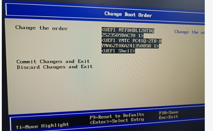

The issue has been resolved by modifying ./edk2/NetworkPkg/NetworkPkg.dec
in the UEFI source code.
The effect is as follows:
Nvidia should add your solution to its DeveloperGuide. Thanks for posting it.
Hi 1516775545,
uefi_t26x_embedded.bin is similar as the miniUEFI we called in Jetpack 6. It will disable few functions in UEFI and keep all necessary drivers for booting.
