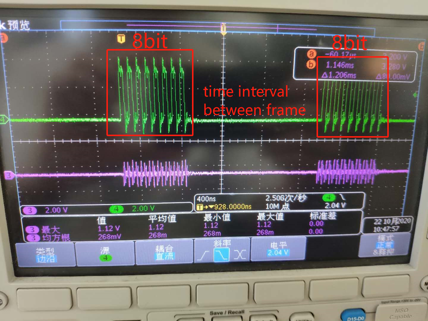

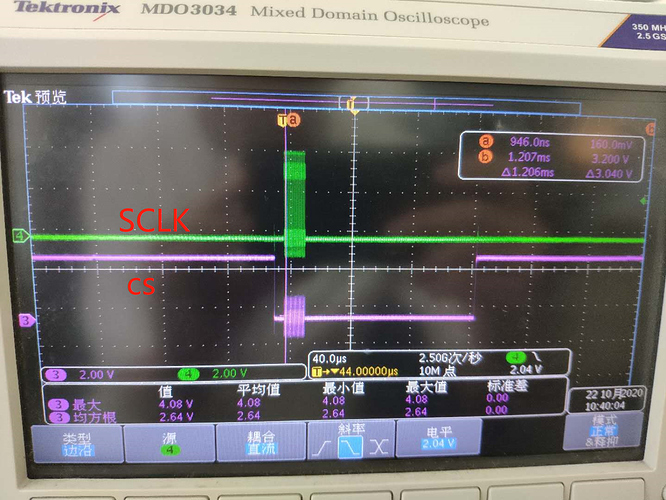

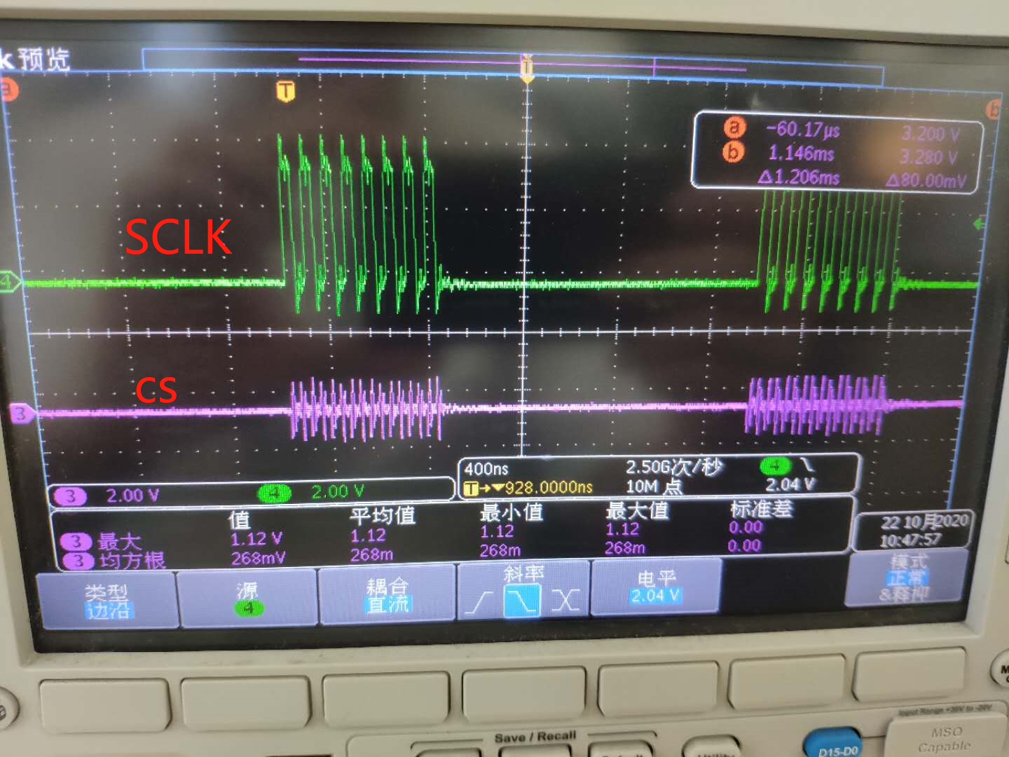

Hi CCC, I can use SPI communicate on agx board, but the Picture1 waveform I collected with the oscilloscope is not what I want. Picture 2 is the waveform I want. The same spidev_test program(8bit 12000000hz) is used and the parameters are the same. What should I change?
I noticed this port Jetson Xavier SPI Timing Characteristics, but I don’t know if it has anything to do with my problem, thanks
Picture1,continuous clock and CS pulse
Picture2,another board SPI,interval clock and CS pulse
SPI interval between two frames of data

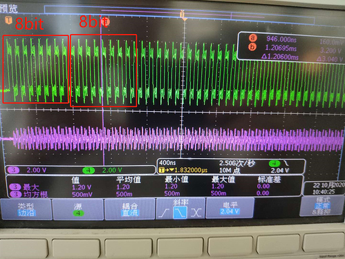

Hi CCC, I try your suggest, as below pic
but it did not solve my problem. My problem is the time interval between frame (not packet) and frame (8bit pulse), what needs to be set?

agx:
other(right scope):
The “nvidia,clk-delay-between-packets” may need using cs-gpios.
you once said in this post “You don’t need add “cs-gpios = <>” for these cs pins. The cs-gpios means you want to use any others gpio pin as cs. These two pin already configure as cs already.”
Sorry, I didn’t aware your are using “nvidia,clk-delay-between-packets” and you need to configure those pin as GPIO instead of SFIO pin.

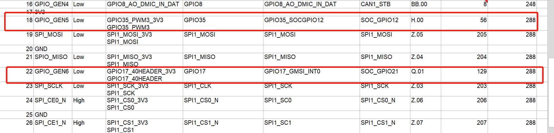

How to get gpio num if using “nvidia,clk-delay-between-packets”?(I think its not use /sys/kernel/debug/tegra_pinctrl_…)
You can select any GPIO pin from the Xavier pin header to connect to the device cs and define it in the device tree.(cs-gpios=<>)
I use these patch now.( [0001-spi-tegra-fix-SPI-setup-and-hold-times.patch.txt]) , [0002-spi-tegra-optimize-delay-between-packets.patch.txt]
this is my device tree configuration, GPIO num reference “Jetson-Xavier-GPIO-mapping”, but still have problem. Please help to see if there is a problem with the configuration.

Could you file new topic and give proper header and much detail information then I can consult with nvidia developer.
