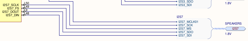

In our design of a custom carrier board the port I2S7 is used. In the pinmux tool I can not map pins L50, L49, L9 and L48 to I2S. I’m using version 1.4 of Pinmux_Template.
Available options:
L9: unused, GPIO3_PV.00
L48: unused, GPIO3_PU.00, CCLA_LA_TRIGGER_MUX
L49: unused, GPIO3_PV.01, GP_PWM10
L50: unused, GPIO3_PU.06
How to proceed here?

@ChrisB_NV Can you please specify what you mean with ‘not supported’ here? We have been able to setup and use I2S7 so I’m a bit puzzled by this answer if it is that Nvidia doesn’t give any help or support using this interface or not recommend using it for some reason or something else?
I manually specified my pins for I2S7 like this in the pinmux dts:
soc_gpio170_pu0 {
				nvidia,pins = "dap7_in_pu0";
				nvidia,function = "i2s7_sdata_in";
				nvidia,pull = <TEGRA_PIN_PULL_NONE>;
				nvidia,tristate = <TEGRA_PIN_ENABLE>;
				nvidia,enable-input = <TEGRA_PIN_ENABLE>;
				nvidia,drv-type = <TEGRA_PIN_1X_DRIVER>;
				nvidia,e-io-od = <TEGRA_PIN_DISABLE>;
				nvidia,e-lpbk = <TEGRA_PIN_DISABLE>;
soc_gpio176_pu6 {
				nvidia,pins = "dap7_sclk_pu6";
				nvidia,function = "i2s7_sclk";
				nvidia,tristate = <TEGRA_PIN_DISABLE>;
				nvidia,enable-input = <TEGRA_PIN_DISABLE>;
soc_gpio178_pv0 {
				nvidia,pins = "dap7_out_pv0";
				nvidia,function = "i2s7_sdata_out";
pwm10_pv1 {
				nvidia,pins = "dap7_fs_pv1";
				nvidia,function = "i2s7_lrck";
With this settings, derived/guessed from other i2s interfaces, together with Linux device-tree and codec setup we are able to get sound out of I2S7.
