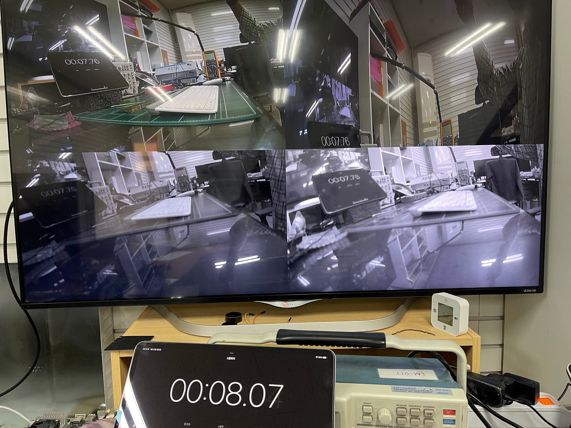

I was tested 4K(3840x2160)/60fps and 4channel camera streamming in AGX Xavier.
I confirmed that there is a video delay time. (it’s about 300miliseconds )

Is there a way to reduce the video latency or something to review?
Does single camera get the same result?
Yes, single camera preview was also same delay.

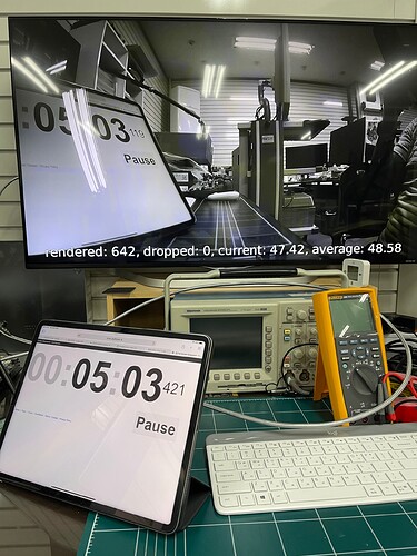

Did you check if the frame rate consistent reach 60fps for single camera?
How do i check frame rate in gstreamer streaming?
Check with below command.
gst-launch-1.0 nvarguscamerasrc sensor-id=0 ! 'video/x-raw(memory:NVMM),width=1920,height=1080,framerate=30/1,format=NV12' ! nvvidconv ! fpsdisplaysink video-sink=xvimagesink sync=false -v
I was checked fram rate as your help in single camera 4K / 60fps.
display latency is 300ms .
frame rate is 48.58fps

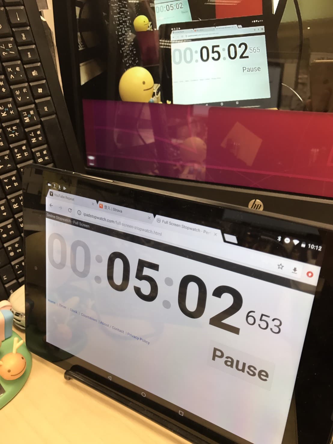

Could you check with 1280x720@60 sensor mode.
We got about 80 ~ 100 with reference sensor ov5693
custom sensor just support 1920x1080 (FHD) mode.
video latency time is same 300ms
frame rate is 59.69fps as shown below.
Do you have reference sensor e3326(ov5693) to verify?
No, i didn’t verify ov5693.
