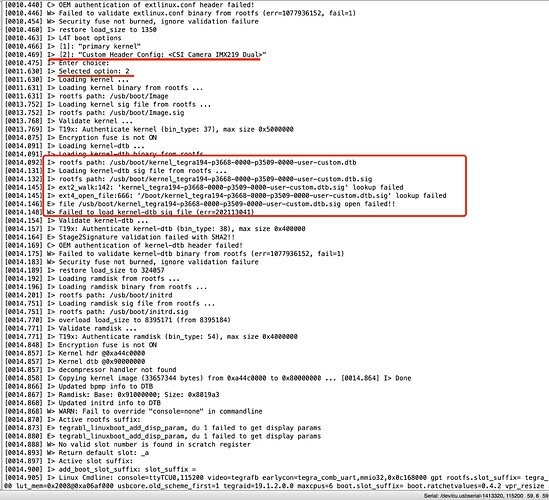

When I do gst-launch-1.0 nvarguscamerasrc sensor-id=1 ! 'video/x-raw(memory:NVMM),width=1280, height=720, framerate=30/1, format=NV12' ! nvvidconv flip-method=0 ! 'video/x-raw,width=960, height=540' ! nvvidconv ! nvegltransform ! nveglglessink , that works on Xavier NX board in system r32.7.1 (kernel version: 4.9.253) with csi-camera imx219. Then I update the system to r35.1(kernel version: 5.10.104) ,with same hardware environment, that show an error !!!
Using winsys: x11
Pipeline is live and does not need PREROLL ...
Got context from element 'eglglessink0': gst.egl.EGLDisplay=context, display=(GstEGLDisplay)NULL;
New clock: GstSystemClock
Error generated. /dvs/git/dirty/git-master_linux/multimedia/nvgstreamer/gst-nvarguscamera/gstnvarguscamerasrc.cpp, execute:751 No cameras available
WARNING: from element /GstPipeline:pipeline0/GstEglGlesSink:eglglessink0: Pipeline construction is invalid, please add queues.
Additional debug info:
gstbasesink.c(1209): gst_base_sink_query_latency (): /GstPipeline:pipeline0/GstEglGlesSink:eglglessink0:
Not enough buffering available for the processing deadline of 0:00:00.015000000, add enough queues to buffer 0:00:00.015000000 additional data. Shortening processing latency to 0:00:00.000000000.
Got EOS from element "pipeline0".
Execution ended after 0:00:00.068838895
Setting pipeline to READY ...
Setting pipeline to NULL ...
Freeing pipeline ...
(Argus) Error EndOfFile: Unexpected error in reading socket (in src/rpc/socket/client/ClientSocketManager.cpp, function recvThreadCore(), line 266)
(Argus) Error EndOfFile: Receive worker failure, notifying 1 waiting threads (in src/rpc/socket/client/ClientSocketManager.cpp, function recvThreadCore(), line 339)
(Argus) Error InvalidState: Argus client is exiting with 1 outstanding client threads (in src/rpc/socket/client/ClientSocketManager.cpp, function recvThreadCore(), line 355)
(Argus) Error EndOfFile: Receiving thread terminated with error (in src/rpc/socket/client/ClientSocketManager.cpp, function recvThreadWrapper(), line 368)
(Argus) Error EndOfFile: Client thread received an error from socket (in src/rpc/socket/client/ClientSocketManager.cpp, function send(), line 145)
(Argus) Error EndOfFile: (propagating from src/rpc/socket/client/SocketClientDispatch.cpp, function dispatch(), line 91)
Is there a solution,Bro.
