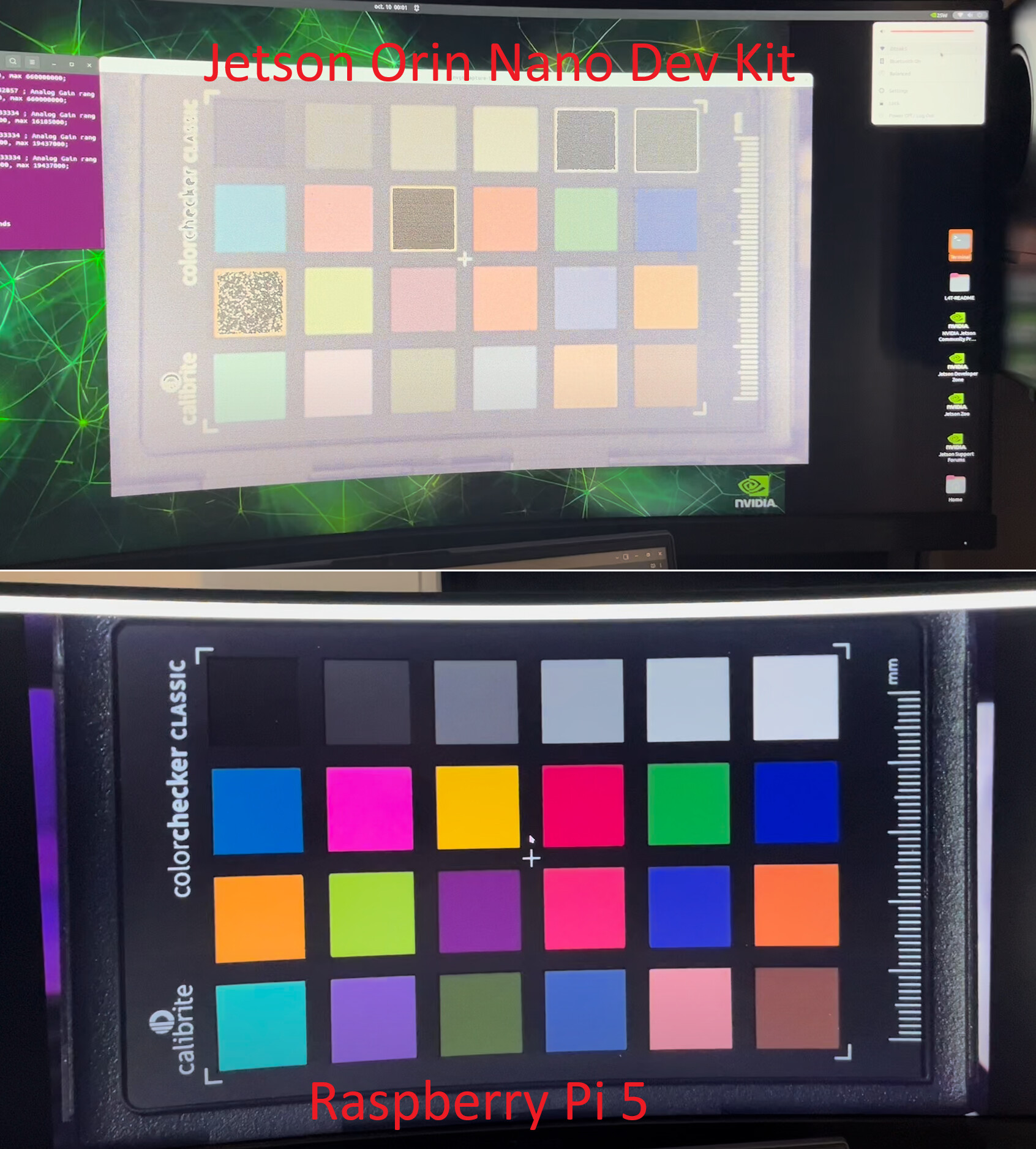

I’m using an FSM:GO-IMX678C module on a Jetson Orin Nano Super dev kit with the “FPA-A/P22-Kit” adapter board and cable, CAM1. I followed their instructions to download, install, and configure their drivers. Here and here.
After, running nvgstcapture-1.0 (or their ./display_image_isp example, or v4l2-ctl) all give me a severely distorted image, with washed out colours and clipping highlights. I’m on Jetpack 6.2.1 / 36.4.4, but I also tried 6.2 / 36.4.3 before this. Tried CAM0 and CAM1. Both have the same issue.
Installing their drivers on a raspberry pi and plugging the camera into that does give me a clean image, so am pretty sure it’s not the camera.
Does anyone have a clue what could be up? I’ve been stuck for a couple of days now

Looks like the clipping is from the default mode being an unprocessed HDR mode. Using “nvgstcapture-1.0 --sensor-mode=0” give me an image without clipping, but still has messed up colours, and is exceptionally blurry compared to the HDR mode.

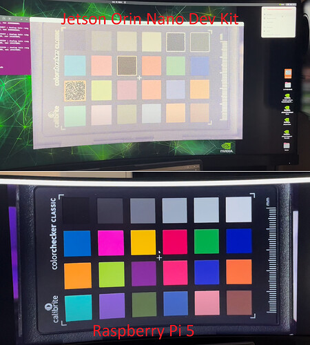

Which I believe means it’s not loading the ISP file correctly. Manually overriding the IMX678.isp file from FRAMOS makes things better, but still far from the clean image it provides on the raspberry pi. Same lighting as the previous images:
Does anyone know what could be at the source of this problem? I feel like I’m patching things up in the wrong place
Hello @Flimcakes,
Quick couple of questions:
  1. Could you please confirm that the ISP configuration file you are using is IMX678_IRC650.isp from the Framos repo?
  2. From the argus logs I think you are correct and the ISP config file is not being loaded correctly by the system. What procedure are you following to override it ?
  3. Can you please share your capture command ? Is it a GStreamer pipeline or are you using nvgstcapture-1.0 ?
We have been seeing recently some issues with the noise reduction filter, where it is applied to hard and causes a blurry image. However in this case it actually looks like no noise reduction is being applied.

I wasn’t too clear in my last message - long day - I did the ISP override halfway through the post. The blurriness went away, and the colors got a bit better after. To what it looks like in the image I attached at the end of that post. The IMX678_IRC650.isp appears to be applied correctly now. I used this procedure. As the step was marked “optional” in the documentation I didn’t do this at first, and assumed the file would be loaded automatically after installing the drivers.
So now I’m still at the point where I’m getting the noisy low contrast image seen in that image, where the raspberry pi gives a really clean image without fuss. Do you know anything else I could try?
