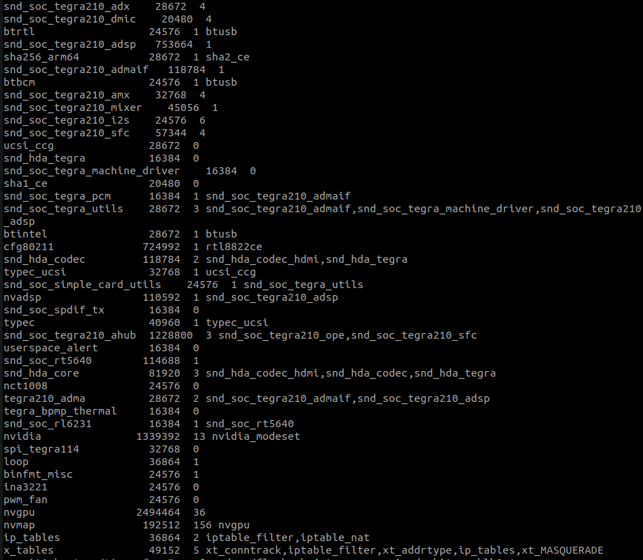

Hello.
I want to install real-time kernel on Jetson Orin PC.
The currently installed kernel version is 5.10.104-tegra.

I succeeded in proceeding with To Build the Real-Time Kernel from decompressing Public_sources.
And, by executing To Build the Kernel, the kernel_out folder was also created.
Referring to the manual(Build the Real-Time Kernel - #4 by wai.kwok.law), it told me to proceed with the commands below, but I proceeded with all of them, but an Invalid target board error occurred in the last flash.sh.
$ sudo tar xpf JAX-TX2-Jetson_Linux_R32.1.0_aarch64.tbz2 (2번 파일 압축 해제)
$ cd Linux_for_Tegra/rootfs/
$ sudo tar xpf …/…/JAX-TX2-Tegra_Linux_Sample-Root-Filesystem_R32.1.0_aarch64.tbz2
$ cd …
$ sudo ./apply_binaries.sh
$ sudo ./flash.sh --no-flash jetson-xxxx mmcblk0p1
There doesn’t seem to be a separate manual for the above command. I would appreciate it if you could tell me again how to do the last step.
And two Linux_for_Tegra files were created (files 1 and 2 were decompressed respectively), file 1 had kernel_out and file 2 had rootfs
is in a state of being.
The nvgpu.ko file located in rootfs has been replaced with a file created in the kernel_out folder.
There is a make command in the manual(Nvidia_kernel_display_driver_source.tbz2 not support real-time kernels - #19 by carolyuu). In which folder is the command executed?
And when the make is completed, can I just change it to real-time according to the manual(Kernel Customization — Jetson Linux<br/>Developer Guide 34.1 documentation)?
In fact, I’m not sure if I did it right because the manuals and forums are jumbled up.
