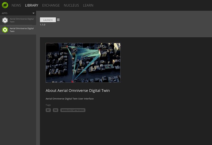

Thanks for the help. Installation got completed successfully, but now the application is not launching from the omniverse launcher.
I have attached the log corresponding to when launching the version 1.1 of the AODT in this thread for reference.
Kindly let us know, if we need to meet online for sorting this issue if required.
Thanks in advance.

@shivshankar Can you provide additional details-
  1. The AODT window does not come up?
  2. Are you able to open another app from library e.g. USD composer?
  3. The attached log looks incomplete-it does not show the point of failure. Can you please recheck?

  1. Yes the AODT window is not coming up.
  2. We are unable to see any other app in the library. Only the two versions of AODT are available in there.
  3. We are unable to understand the logs. Can you tell us what is missing in this case
