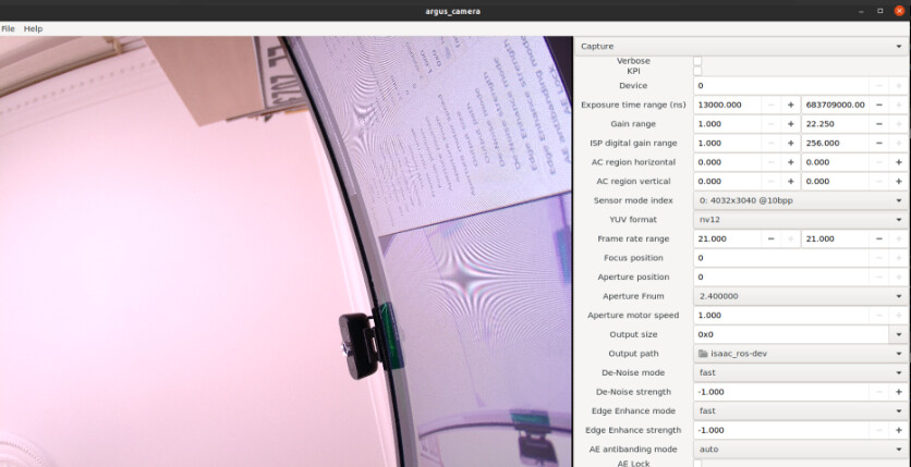

Hello everyone I am trying to run isaac_ros_argus_camera with ros2 launch isaac_ros_argus_camera isaac_ros_argus_camera_stereo.launch.py or mono but I cannot make isaac ros argus to publish my camera data everything looks fine but I guess I am missing something.
I tried to give as much detailed information as I can below error log etc. but if you need more information I can give it. Thank you very much in advance to anyone who can help.
Log/Error Details
Output of the following code is
ros2 launch isaac_ros_argus_camera isaac_ros_argus_camera_stereo.launch.py mode:=0 camera_type:=0 fsync_type:=0 camera_info_url:=~/test_calibration.ini
this =>

L4T: 35.4.1
Jetpack 5.1.2
NVIDIA Jetson Orin NX (8GB ram)
isaac-ros-argus-camera environment => I am using Docker image

Thank you for your warm welcome @Raffaello ,
I am using this camera driver in github ArduCAM/MIPI_Camera/releases
jetson-stats output =>
This is output of custom node that I wrote my for my camera to publish camera data
Custom node code

Hi @Raffaello ,
I’m writing because I want to keep you up to date, and maybe we can find solution to my problem from here.
I tried arducam IMX477 PTZ camera and I installed its driver and tried to launch mono camera and it is working
ros2 launch isaac_ros_argus_camera isaac_ros_argus_camera_mono.launch.py
Note: the blur is because of focus problem I solved that later
Output of v4l2-ctl --list-formats-ext --device /dev/video0
Output of argus_camera
It looks like argus camera is working fine with arducam IMX477 PTZ => https://www.arducam.com/product/arducam-imx477-12mp-ptz-camera-for-raspberry-pi-4-3b-3-and-jetson-nano-xavier-nx-ir-cut-switchable-camera-with-metal-base-and-2-digital-servos/ this is the camera link.
However it is not working with arducam ar0234, maybe these information that I provide may give us a different perspective
Thanks in advance,
Yavuz
