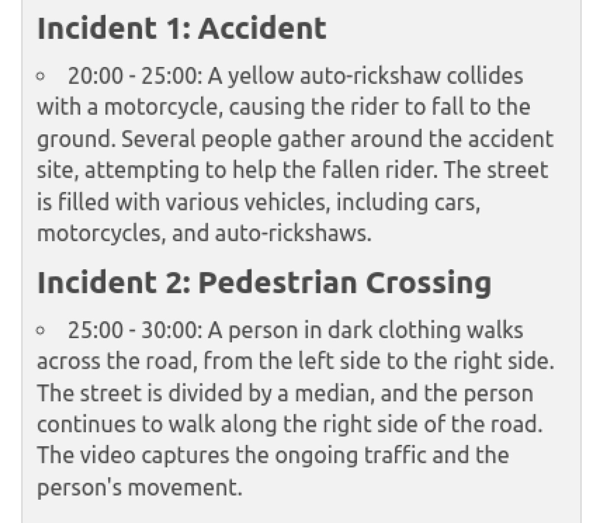

I have deployed highres nvila model.
Summary shows accident but Q&A doesnt show accidents. And It is not Generating Video Highlight.
Summary shows accident but Q&A sometimes doesnt show accidents. It is inconsistent.

I have tried that on my side. It works normally. Could you try to delete the video and summarize that again?
There are multiple accidents but it doesn’t show.
Accuracy is missing.
Could you tell me the reason and please give me the solution.
I’ve deployed the highres nvila model, but it’s not detecting all accidents—only a few are being recognized, and the overall accuracy is lacking. I believe the issue might be related to the model itself.
Could you please advise me on how to improve detection accuracy or how I can get more complete accident detection, on Q&A? I’d really appreciate your help.
