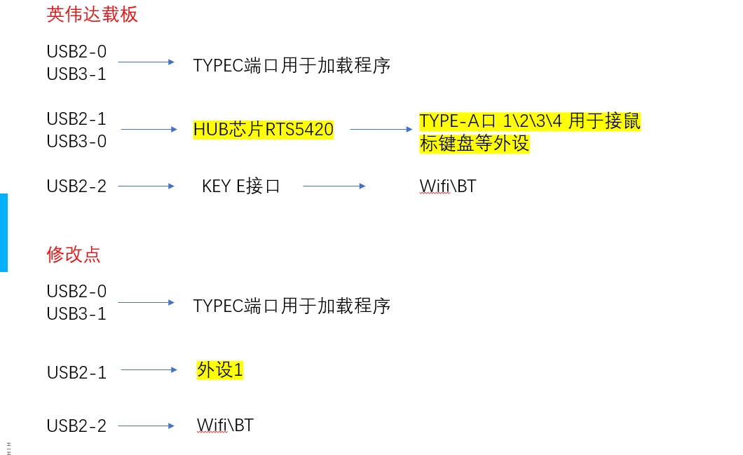

For a custom-designed carrier board, only the usb2-0 and usb3-1 Type-C ports are used according to our needs. The fusb301tmx chip logic is the same. The rts5420 hub chip corresponding to usb2-1 and usb3-0 is not used, so the rts5420 chip and Type-A ports are not soldered.

We want to remove the rts5420 chip and have the Type-C usb2-0 and usb3-1 ports work properly both as host and device. Could you please advise on the correct software-level modifications needed to achieve this?
