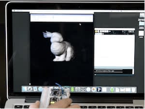

Roll, Pitch, Yaw
Roll, pitch and yaw are typically predicted with an Inertial Measurement Unit (IMU). 9-axis MEMS IMU’s which combine a gyroscope, magnetometer, and accelerometer are relatively cheap and may work well for this purpose. The raw accelerometer, magnetometer and gyroscope data are combined by a sensor fusion algorithm to produce the absolute roll, pitch and yaw. This sensor fusion might be complicated to do from scratch, and often needs to run at high rates and strict timing. For this reason, it may be worth looking for a solution that does this processing internally. For example, the following IMU performs sensor fusion and outputs the predicted orientation over I2C.
You may be able to integrate this directly with Jetson over I2C.
As a disclaimer, I haven’t personally tested the hardware I mentioned, so it is possible you would run into issues, but hopefully this serves as a starting point.
