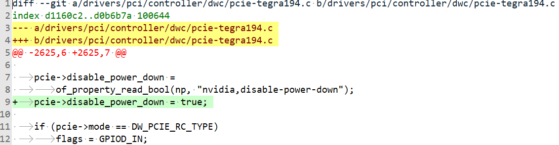

Jetpack6.0 the attached file of tuning guide can't be found
Hi Nvidia,
In the Jetpack6.0 the attched file of tuning guide can’t be found pcie-tegra194.c and bpmp.dtb.dts,but the jetpack5 can be found them and modified. Could you please how to find these files.The image as below.
Above file is not in use for Jetpack6. You should check with latest tuning guide.
I download the attached file of the latest tuning guide,but the document file is the same as the last version.
Could you please tell us where is modified in jetpack6.0?
This might be it.
Linux_for_Tegra/source/kernel/kernel-jammy-src/drivers/pci/controller/dwc/pcie-tegra194.c
docs.nvidia bpmp dtb
there are 3 files in the attachment. And you only opened 2 files.
Add 3 image as below
Yes, that “disable-power-down.diff” is the one for rel-36.
I don’t understand the rel-36.
“Jetpack” is just a word that includes many things. It has the OS, CUDA, TensorRT …etc.
Each of them has its own version.
All the Jetpack5 software is based on rel-35.x OS.
All the Jetpack6 software is based on rel-36.x OS.
Got it. I will try it,thanks.
