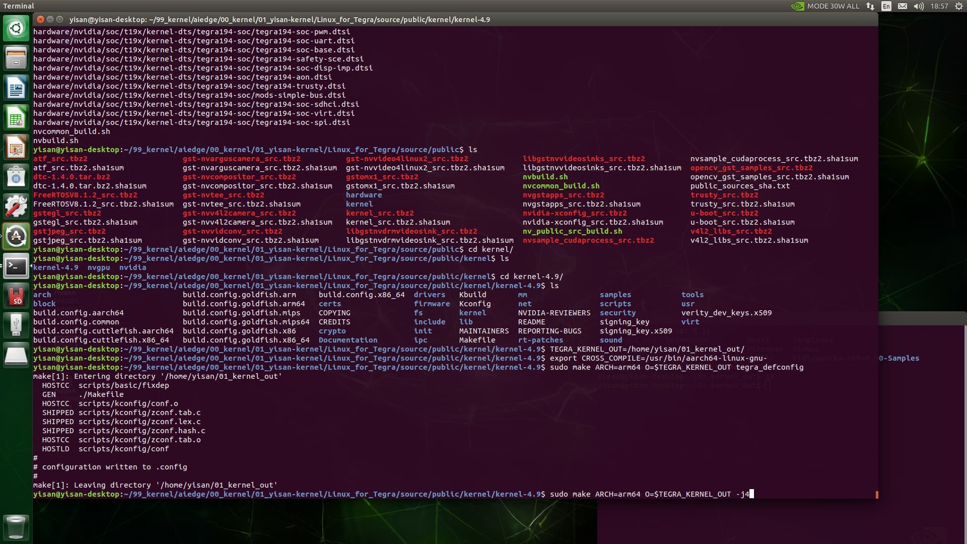

Jetson AGX installed JETPACK 4.6 (REV.3) as SDK.
I modified it in Makefile. 4.9.253 → 4.9.254
Check after applying kernel
I’m done with number 4
I copied the /arch/arm64/boot/Image file to /boot.
I copied the /arch/arm64/boot/dts/tegra194-p2888-0001-p2822-0000.dtb file to /boot/dtb/kernel_tegra194-p2888-0001-p2822-0000.dtb.
No screen output to HDMI to USB-C.
Did I make a mistake?

Did you have below command when build your kernel? What’s the uname -a shows
export LOCALVERSION=-tegra
yes.
export CROSS_COMPLE=/usr/bin/aarch64=linux-gnu-

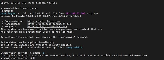

uname -a :
Linux yisan-desktop 4.9.254 #1 SMP PREEMPT Tue May 3 15:50:35 KST 2022 aarch64 aarch64 aarch64 GNU/Linux
I modified only the version part in makefile
4.9.253 → 4.9.254
Looks like lost the string “-tegra” like below
nvidia@nvidia-desktop:~$ uname -a
Linux nvidia-desktop 4.9.140-tegra #1 SMP PREEMPT Thu Jun 25 21:22:12 PDT 2020 aarch64 aarch64 aarch64 GNU/Linux

Looks like lost the string “-tegra” like below.
Still no usb-c to hdmi video.
All situations were recorded with screenshots.
I compiled Jetson AGX.
Don’t run the sudo to make that will lost the export LOCALVERSION=-tegra
You can sudo su to enter supervisor mode then set up the environment to build the kernel if your source tree need sudo to access.
