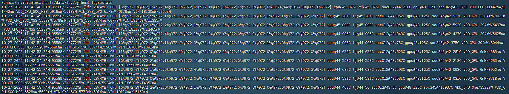

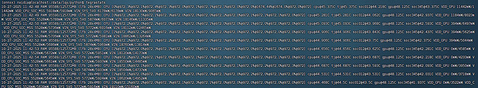

我想请教一下,我按照你这边的程序进行跑qwen2.5,但nvidia-smi还是显示为0,这是为什么呢。
谢谢回复
Please note that the GPU is only active when an inference task is deployed.
This means the GPU can be idle when running the vllm serve ... as it is waiting for a task.
Based on your log, both CPU and GPU are in very low usage so there might not be a job running.
Please capture the utilization when running the curl command instead.
