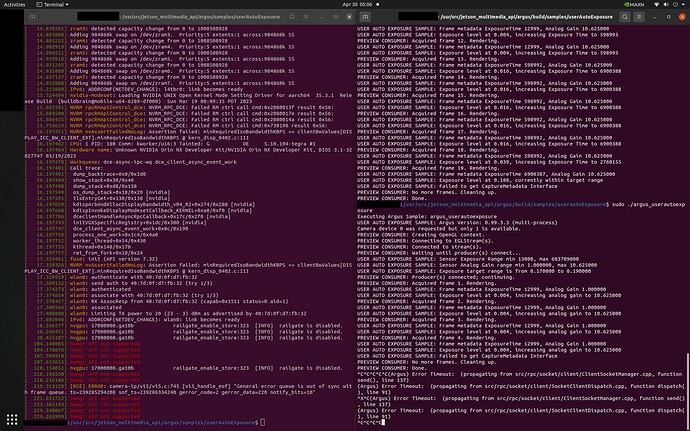

The thread you mentioned is exactly what I wrote down in my first message to be one of the things I have tried out. So using the provided and updated camera drivers in this thread, I have now tried your suggested /usr/src/jetson_multimedia_api/argus/samples/userAutoExposure/.
However, I get the following error, which you can see below:
the expectation is MIPI signal should coming to CSI brick continuously without errors.
by default, it’s error handling mechanism to abort when a frame becomes corrupted.
as you can see… it’s sample app to check EventTypes,
so, you may modify the code to drop error frames, and continue wait for next good frames.

Yes I already saw that. However this is not where the application is failing. If you look at the output of the terminal you can see the following output: Failed to CaptureMetadata:
From the script for autoexposure you can see the the event got the type for completion.
if (iEvent->getEventType() == EVENT_TYPE_CAPTURE_COMPLETE) {
frameCaptureLoop++;
const IEventCaptureComplete* iEventCaptureComplete
= interface_cast<const IEventCaptureComplete>(event);
EXIT_IF_NULL(iEventCaptureComplete, "Failed to get EventCaptureComplete Interface");
const CaptureMetadata* metaData = iEventCaptureComplete->getMetadata();
const ICaptureMetadata* iMetadata = interface_cast<const ICaptureMetadata>(metaData);
EXIT_IF_NULL(iMetadata, "Failed to get CaptureMetadata Interface");
Please is there a way to continue the application wihtout the need to restart it. For my error above or the EVENT_TYPE_ERROR. Otherwise the use of MIPI Cameras is not an option for us. I have checked the hardware connection several times. We have a robotics application which is running for ours and aborting the application is not an option. We could however skip a frame.
Please could you provide a solution and / or sample application which is robust to intermitted MIPI signals ?
as mentioned, so far the way to handle corrupt frames is Argus will report it via EVENT_TYPE_ERROR, it’ll lock the queue, stopping the capture request, abort the pipeline. and the application has to shutdown.

for your use-case to skip a frame, please give it a try to revise the code to skip current capture buffer, for example, if (iMetadata == NULL) continue; to start while loop for the next frame.
