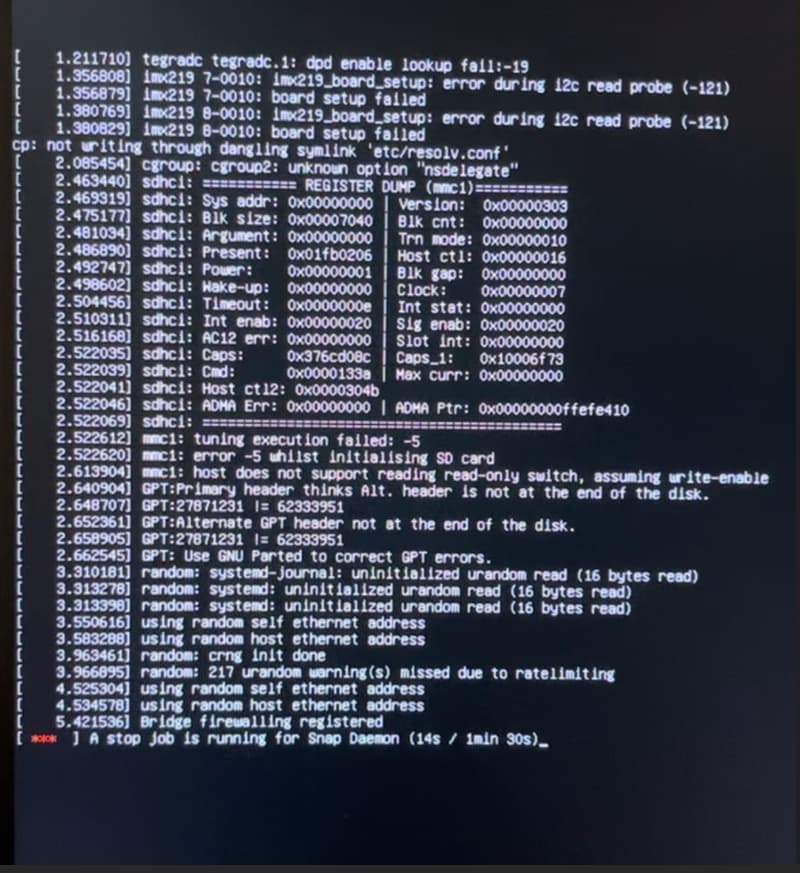

When I try to install jetson nano with jetpack , I always get fail… I have tried jetpack 4.6 and 4.5 versions, also same , I have tried different sd card , I have used Belena Etcher in Windows and Ubuntu, Result is same , Please help me I couldnt solve this problem.,

Don’t try anything for now. Just answer below question first
- Is this a NV devkit or custom board or you don’t know what does this question mean?
- Share the serial log from UART console by using this.
https://www.jetsonhacks.com/2019/04/19/jetson-nano-serial-console/
Hello This is Jetson Nano kit .Please look out image, I have bought in this week, I tried to installNVIDIA jetpack version 4.5 / 4.6 or ubuntu ,everytime I got the error, please look out video and image at the first post.
“Share the serial log from UART console by using this.” I have no idea serial log from uart , I will try… Some people have got same problems ,i but there is no solution (“

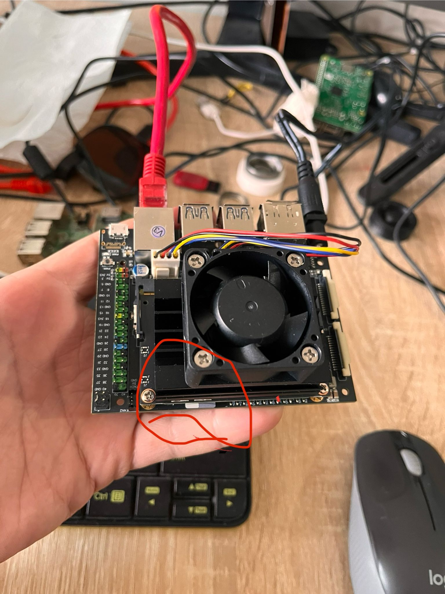

Actually, there are lots of carrier board that is not real NV devkit nowadays though they claimed it is… We have seen a lot of such case.
And you picture seems not a real NV devkit… Please take a picture of where the sdcard slot located on your board.

I just saw this video when I try to solve my problem , here is a my board photo please look out , I marked sd card location with red cycle
Yes, this board is not a NV devkit.
Sdkmanager or NV sdcard image won’t work on this board.
Please check the board vendor’s website for the customized BSP they are using to enable this board.
BSP is the whole package to flash to the board.
For example, the OS is included in the BSP.
The carrier board you are using is not directly released from us so it has some hardware difference from our real NV devkit.
We don’t know what hardware diff it is. Basically you need to check with the board vendor for such custom board from them.
And basically they will provide their package on their website.
