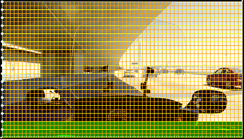

I checked the h265 and h264 with analyzing tools inserting many different params in the GDR conf file.
My conclusions so far:
  1. the gdr_start_frame_number param works fine for both encoders
  2. the gdr_num_frames split the h264 to correct number of slices
  3. h265 does not affected by gdr_num_frames and always split the frame to 2 or 3 slices - I/P or P/I/P
  4. for both encoders the cycle is always 6 slices no matter what gdr_num_frames I choose - it means that if the gdr_num_frames is bigger than 6 (lets say 10) only 6 of 10 slices will be shown, and the other 4 will get not enough data (stays green on display).
Is there a way to configure it differently or ‘6’ is hard coded and cannot be changed?
Why the H265 does not split to slices like the h264?
Thanks,

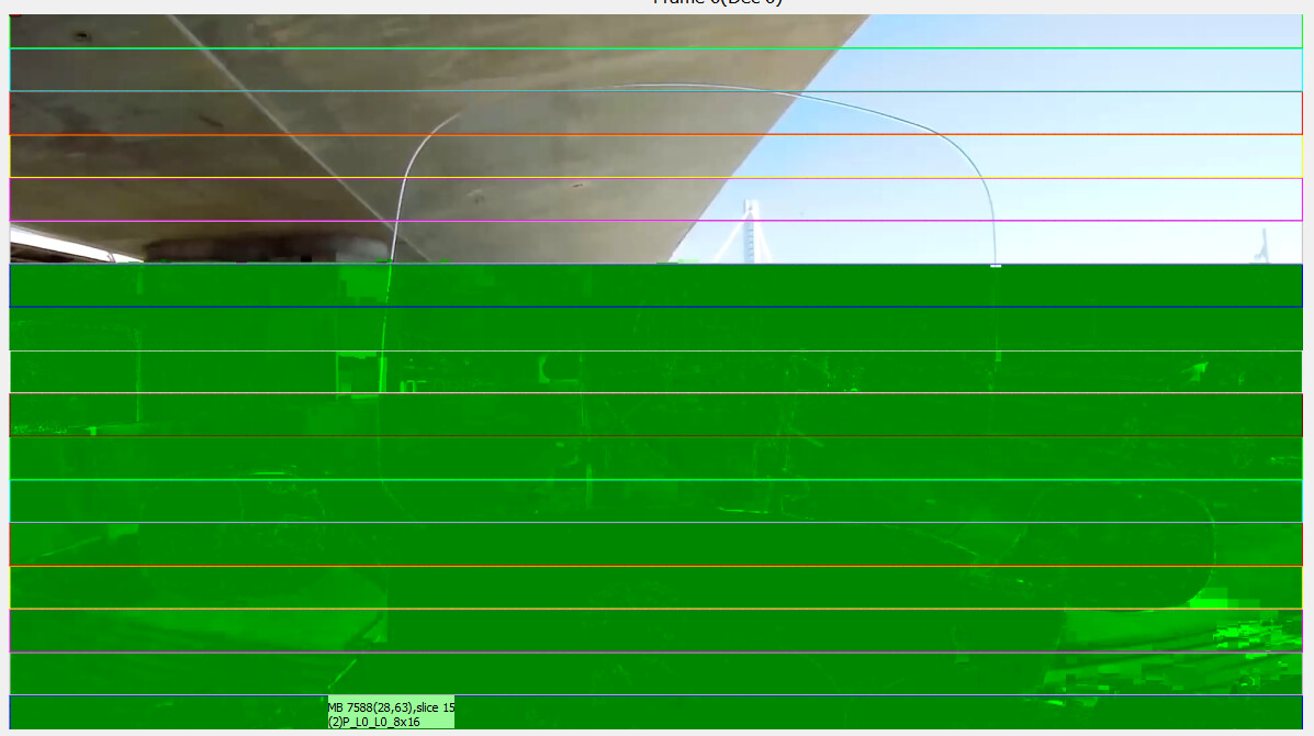

for h264:
17 slices - I-frame cycle with only first 6

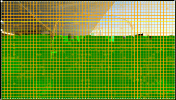

for h265:
it seems like the I-frame “knows” there are 17 slices - cycle with only first 6. the P-frames are always the rest of the picture - not sliced into the other 6 but only 1/2 P-frames each Frame.

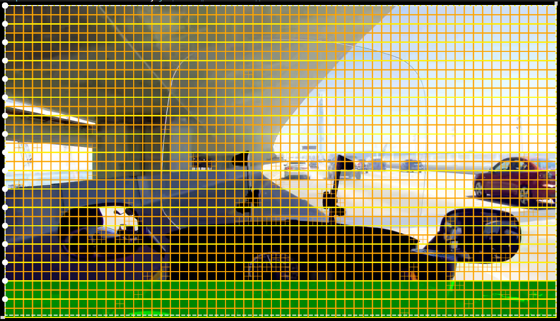

h265 from another encoder:
you can see how it sliced into 17 - the I-frame cycle between all.
in this example I took the 15th Frame so the last two still green.
Which property suppose to affect the slices cycle (which is now constant 6)?
