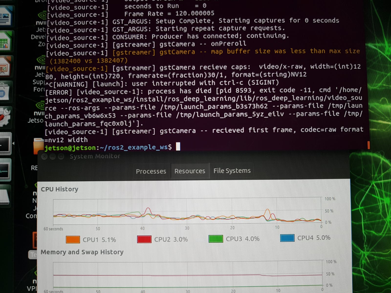

Hi, Finally I tried this.
this is my result.
As I know it should consume much less cpu, im I right?
or are these values normal?
I think my jetson consumes much more than needed i dont know why.
thanks in advance.
Only one camera used. only video source launched.
I don’t have CPU usage numbers to quote you on, but understand that ROS image transport has a certain amount of overhead. Perhaps others in the community may have some further suggestions.
