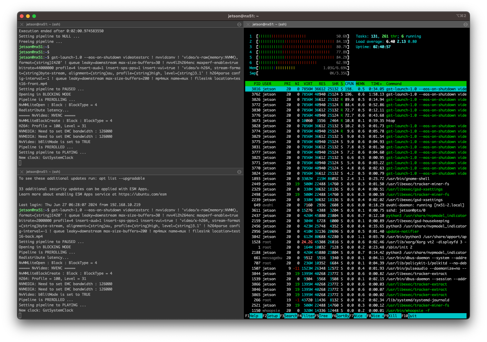

Does others source element like videotestsrc have the same result?
I tried with videotestsrc instead of the nvarguscamera and I can see the same difference in CPU syscals, just not so dramatic, since videotestsrc uses a lot of CPU as well:
