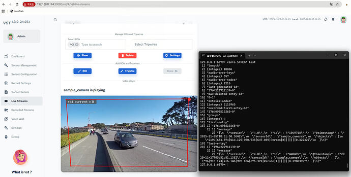

Hi NVIDIA team,
I am currently working with the official reference-workflow-and-resources_2.0.1.zip package and trying to integrate the following components on my Jetson device:
  • VST (nvcr.io/nvidia/jps/vst)
  • DeepStream 7.1
  • Redis (STREAM test)
  • EMDX Analytics (jps_v1.2.9)
  • emdx-webapi
  • LiveStream Web UI
The basic workflow is functioning, but the Analytics UI seems extremely limited, and I cannot access any rule-related configuration pages (Object class, Operation, Rule creation, etc.). I would like to clarify whether this behavior is expected for version 1.2.9 or if I am missing required components.
My Environment
  • JetPack Version: 6.1
  • DeepStream Version: 7.1
  • TensorRT Version: 10.3.0.30-1+cuda12.5
  • reference-workflow-and-resources: 2.0.1
  • Analytics container: nvcr.io/nvidia/jps/emdx-analytics:jps_v1.2.9
What Works Correctly
    1. DeepStream-test5-app is running inference normally.
    2. Redis STREAM test contains valid PeopleNet metadata
      • bbox / class / confidence present and correct
    3. Analytics container is consuming the Redis stream
      • logs show datasink_0 with normal messages/sec
    4. VST LiveStream UI works and ROI drawing works (but has no effect).
The Actual Problem: Analytics UI is Missing Most Features
The EMDX Analytics Web UI only shows a very minimal interface.
It does NOT include:
  • Object class selection (Person / Vehicle / Bike…)
  • Operation types (enter zone, exit zone, dwell time, counting…)
  • Rule creation / editing interface
  • Behavior configuration
  • Event logging / alerting
  • Analytics overlay in LiveStream
Because of this:
  • I can draw ROI, but it has no effect
  • I cannot create rules
  • No events are generated
  • LiveStream does not show analytics overlay
This appears very different from what is shown in NVIDIA solution demos and MOJ Analytics screenshots.

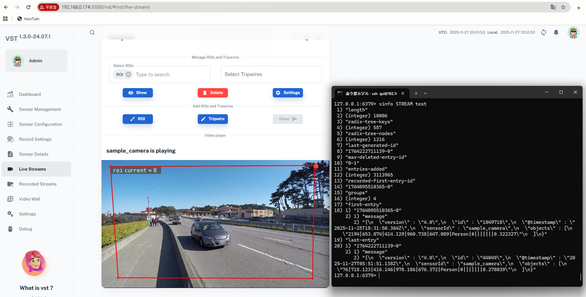

You can set tripwire and ROI counting in VST UI. Please refer this topic: Tripwire/ROI Not counting on Jetson Orin Nano - #3 by kesong
I followed the documentation you provided, but the current ROI value still stays at 0.
Redis also seems to have data, but I still can’t figure out where the problem is.
Please Help me.
Please set below with IP address instead of localhost.
“analytic_server_address”: “http://:30080/emdx”
I changed the URL, but it shows “Not Found”.
I also confirmed that the analytic_server_address setting is correct.
Here is the related information.
Could you please take a look and help me identify the issue?
Thank you.

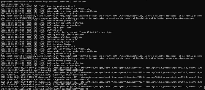

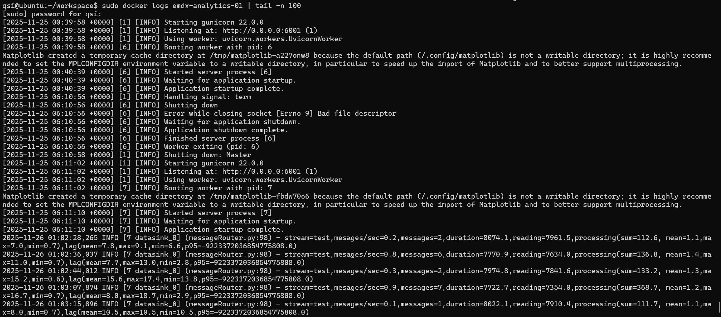

analytic_server_address set detail
sudo docker logs emdx-webapi | tail -n 50
qsi@ubuntu:~$ sudo docker logs emdx-webapi | tail -n 50
[2025-11-27 05:36:09 +0000] [1] [INFO] Starting gunicorn 22.0.0
[2025-11-27 05:36:09 +0000] [1] [INFO] Listening at: http://0.0.0.0:5000 (1)
[2025-11-27 05:36:09 +0000] [1] [INFO] Using worker: uvicorn.workers.UvicornWorker
[2025-11-27 05:36:09 +0000] [7] [INFO] Booting worker with pid: 7
/usr/lib/python3.12/site-packages/tzlocal/unix.py:158: UserWarning: Can not find any timezone configuration, defaulting to UTC.
  warnings.warn('Can not find any timezone configuration, defaulting to UTC.')
Run time of job "ageing_job (trigger: cron[hour='*/1'], next run at: 2025-11-26 03:00:00 UTC)" was missed by 1 day, 2:36:12.676322
Run time of job "ageing_job (trigger: cron[hour='*/1'], next run at: 2025-11-27 06:00:00 UTC)" was missed by 1 day, 1:36:12.679923
Run time of job "ageing_job (trigger: cron[hour='*/1'], next run at: 2025-11-27 06:00:00 UTC)" was missed by 1 day, 0:36:12.681770
Run time of job "ageing_job (trigger: cron[hour='*/1'], next run at: 2025-11-27 06:00:00 UTC)" was missed by 23:36:12.681970
Run time of job "ageing_job (trigger: cron[hour='*/1'], next run at: 2025-11-27 06:00:00 UTC)" was missed by 22:36:12.682083
Run time of job "ageing_job (trigger: cron[hour='*/1'], next run at: 2025-11-27 06:00:00 UTC)" was missed by 21:36:12.682183
Run time of job "ageing_job (trigger: cron[hour='*/1'], next run at: 2025-11-27 06:00:00 UTC)" was missed by 20:36:12.682281
Run time of job "ageing_job (trigger: cron[hour='*/1'], next run at: 2025-11-27 06:00:00 UTC)" was missed by 19:36:12.682398
Run time of job "ageing_job (trigger: cron[hour='*/1'], next run at: 2025-11-27 06:00:00 UTC)" was missed by 18:36:12.682527
Run time of job "ageing_job (trigger: cron[hour='*/1'], next run at: 2025-11-27 06:00:00 UTC)" was missed by 17:36:12.682624
Run time of job "ageing_job (trigger: cron[hour='*/1'], next run at: 2025-11-27 06:00:00 UTC)" was missed by 16:36:12.682711
Run time of job "ageing_job (trigger: cron[hour='*/1'], next run at: 2025-11-27 06:00:00 UTC)" was missed by 15:36:12.682795
Run time of job "ageing_job (trigger: cron[hour='*/1'], next run at: 2025-11-27 06:00:00 UTC)" was missed by 14:36:12.682878
Run time of job "ageing_job (trigger: cron[hour='*/1'], next run at: 2025-11-27 06:00:00 UTC)" was missed by 13:36:12.682956
Run time of job "ageing_job (trigger: cron[hour='*/1'], next run at: 2025-11-27 06:00:00 UTC)" was missed by 12:36:12.683033
Run time of job "ageing_job (trigger: cron[hour='*/1'], next run at: 2025-11-27 06:00:00 UTC)" was missed by 11:36:12.683113
Run time of job "ageing_job (trigger: cron[hour='*/1'], next run at: 2025-11-27 06:00:00 UTC)" was missed by 10:36:12.683190
Run time of job "ageing_job (trigger: cron[hour='*/1'], next run at: 2025-11-27 06:00:00 UTC)" was missed by 9:36:12.683268
Run time of job "ageing_job (trigger: cron[hour='*/1'], next run at: 2025-11-27 06:00:00 UTC)" was missed by 8:36:12.683362
Run time of job "ageing_job (trigger: cron[hour='*/1'], next run at: 2025-11-27 06:00:00 UTC)" was missed by 7:36:12.683447
Run time of job "ageing_job (trigger: cron[hour='*/1'], next run at: 2025-11-27 06:00:00 UTC)" was missed by 6:36:12.683525
Run time of job "ageing_job (trigger: cron[hour='*/1'], next run at: 2025-11-27 06:00:00 UTC)" was missed by 5:36:12.683602
Run time of job "ageing_job (trigger: cron[hour='*/1'], next run at: 2025-11-27 06:00:00 UTC)" was missed by 4:36:12.683677
Run time of job "ageing_job (trigger: cron[hour='*/1'], next run at: 2025-11-27 06:00:00 UTC)" was missed by 3:36:12.683751
Run time of job "ageing_job (trigger: cron[hour='*/1'], next run at: 2025-11-27 06:00:00 UTC)" was missed by 2:36:12.683822
Run time of job "ageing_job (trigger: cron[hour='*/1'], next run at: 2025-11-27 06:00:00 UTC)" was missed by 1:36:12.683895
Run time of job "ageing_job (trigger: cron[hour='*/1'], next run at: 2025-11-27 06:00:00 UTC)" was missed by 0:36:12.683965
[2025-11-27 05:36:15 +0000] [7] [INFO] Started server process [7]
[2025-11-27 05:36:15 +0000] [7] [INFO] Waiting for application startup.
[2025-11-27 05:36:15 +0000] [7] [INFO] Application startup complete.
Run time of job "ageing_job (trigger: cron[hour='*/1'], next run at: 2025-11-27 12:00:00 UTC)" was missed by 0:00:02.613874
Run time of job "ageing_job (trigger: cron[hour='*/1'], next run at: 2025-11-27 13:00:00 UTC)" was missed by 0:00:03.816355
Run time of job "ageing_job (trigger: cron[hour='*/1'], next run at: 2025-11-27 14:00:00 UTC)" was missed by 0:00:02.924379
Run time of job "ageing_job (trigger: cron[hour='*/1'], next run at: 2025-11-27 15:00:00 UTC)" was missed by 0:00:04.631231
Run time of job "ageing_job (trigger: cron[hour='*/1'], next run at: 2025-11-28 01:00:00 UTC)" was missed by 0:00:01.078030
2025-11-27 21:37:25,133 INFO [7 datasink_2] (messageRouter.py:86) - stream=test,mesages/sec=0.3,messages=91,duration=291877.0,reading=287263.6,processing(sum=4613.4, mean=50.7,max=4553.5,min=0.5),lag(mean=52.9,max=4557.2,min=1.7)

2025-11-27 23:44:02,161 INFO [7 datasink_2] (messageRouter.py:86) - stream=test,mesages/sec=0.2,messages=92,duration=563580.9,reading=563519.5,processing(sum=61.4, mean=0.7,max=1.0,min=0.5),lag(mean=3.1,max=7.9,min=1.7)
2025-11-27 23:44:02,162 INFO [7 datasink_2] (messageRouter.py:86) - stream=emdx_trajectory,mesages/sec=0.0,messages=8,duration=563580.9,reading=563549.0,processing(sum=31.8, mean=4.0,max=7.3,min=1.5),lag(mean=5.6,max=9.5,min=2.6)
2025-11-27 23:48:44,152 INFO [7 datasink_2] (messageRouter.py:86) - stream=test,mesages/sec=0.3,messages=95,duration=281990.6,reading=281482.9,processing(sum=507.6, mean=5.6,max=449.1,min=0.5),lag(mean=74.5,max=1409.4,min=1.6)
2025-11-27 23:48:44,153 INFO [7 datasink_2] (messageRouter.py:86) - stream=emdx_trajectory,mesages/sec=0.0,messages=9,duration=281990.6,reading=279164.4,processing(sum=2826.1, mean=314.0,max=2758.9,min=1.1),lag(mean=364.5,max=3202.2,min=2.3)
2025-11-27 23:58:22,018 INFO [7 datasink_2] (messageRouter.py:86) - stream=test,mesages/sec=0.2,messages=95,duration=577864.8,reading=577805.3,processing(sum=59.5, mean=0.7,max=1.4,min=0.5),lag(mean=14.9,max=330.4,min=1.9)
2025-11-27 23:58:22,018 INFO [7 datasink_2] (messageRouter.py:86) - stream=emdx_trajectory,mesages/sec=0.0,messages=9,duration=577864.8,reading=577486.2,processing(sum=378.6, mean=42.1,max=347.0,min=1.3),lag(mean=43.7,max=351.1,min=2.8)
2025-11-28 00:07:59,182 INFO [7 datasink_2] (messageRouter.py:86) - stream=test,mesages/sec=0.2,messages=89,duration=577163.3,reading=575792.6,processing(sum=1370.7, mean=15.4,max=1301.5,min=0.4),lag(mean=17.9,max=1303.3,min=1.6)
2025-11-28 00:07:59,188 INFO [7 datasink_2] (messageRouter.py:86) - stream=emdx_trajectory,mesages/sec=0.0,messages=11,duration=577163.3,reading=577073.1,processing(sum=90.2, mean=8.2,max=51.0,min=1.5),lag(mean=127.1,max=1294.4,min=2.9)
2025-11-28 00:12:15,508 INFO [7 datasink_2] (messageRouter.py:86) - stream=test,mesages/sec=0.4,messages=96,duration=256319.0,reading=256043.3,processing(sum=275.7, mean=3.0,max=215.7,min=0.4),lag(mean=93.7,max=1765.0,min=1.7)
2025-11-28 00:12:15,508 INFO [7 datasink_2] (messageRouter.py:86) - stream=emdx_trajectory,mesages/sec=0.0,messages=9,duration=256319.0,reading=254397.4,processing(sum=1921.6, mean=213.5,max=1788.2,min=1.1),lag(mean=214.8,max=1789.3,min=2.6)
2025-11-28 00:15:28,179 INFO [7 datasink_2] (messageRouter.py:86) - stream=test,mesages/sec=0.6,messages=107,duration=192670.4,reading=189751.5,processing(sum=2918.9, mean=32.4,max=2074.7,min=0.5),lag(mean=80.1,max=2076.4,min=1.7)
2025-11-28 00:15:28,179 INFO [7 datasink_2] (messageRouter.py:86) - stream=emdx_trajectory,mesages/sec=0.1,messages=11,duration=192670.4,reading=192234.5,processing(sum=435.9, mean=39.6,max=400.1,min=1.3),lag(mean=70.2,max=401.1,min=2.6)
2025-11-28 00:24:27,003 INFO [7 datasink_2] (messageRouter.py:86) - stream=test,mesages/sec=0.2,messages=93,duration=538823.9,reading=530209.4,processing(sum=8614.4, mean=93.6,max=4417.9,min=0.4),lag(mean=173.8,max=4420.2,min=1.8)
2025-11-28 00:24:27,004 INFO [7 datasink_2] (messageRouter.py:86) - stream=emdx_trajectory,mesages/sec=0.0,messages=9,duration=538823.9,reading=535273.3,processing(sum=3550.6, mean=394.5,max=1091.0,min=5.7),lag(mean=469.0,max=1092.3,min=7.2)
2025-11-28 00:32:53,878 INFO [7 datasink_2] (messageRouter.py:86) - stream=test,mesages/sec=0.2,messages=117,duration=506874.0,reading=484529.6,processing(sum=22344.4, mean=245.5,max=5076.9,min=0.4),lag(mean=951.1,max=6124.2,min=1.7)
2025-11-28 00:32:53,878 INFO [7 datasink_2] (messageRouter.py:86) - stream=emdx_trajectory,mesages/sec=0.0,messages=12,duration=506874.0,reading=488198.4,processing(sum=18675.7, mean=1556.3,max=6734.1,min=1.0),lag(mean=2374.8,max=6735.1,min=2.0)
2025-11-28 00:47:18,109 INFO [7 datasink_2] (messageRouter.py:86) - stream=test,mesages/sec=0.2,messages=131,duration=864230.7,reading=817642.6,processing(sum=46588.0, mean=517.6,max=14418.6,min=0.4),lag(mean=3261.0,max=16964.7,min=1.9)
2025-11-28 00:47:18,649 INFO [7 datasink_2] (messageRouter.py:86) - stream=emdx_trajectory,mesages/sec=0.0,messages=13,duration=864230.7,reading=807578.4,processing(sum=56652.3, mean=4357.9,max=17574.5,min=1.7),lag(mean=7301.3,max=22444.0,min=3.2)
sudo docker ps
Please share the log of VST container to check if VST can get the count from emdx.
