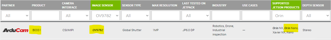

  • I am using the Quad-Camera board from Arducam with SKU B0331
  • Yes the cameras connected before powering jetson on
  • It was mentioned in the Jetson Partner Supported Cameras that this board is supported by Jetson Orin Nano

However, I found on the board specifications that it is for using 2-Lane
Arducam 1MP*4 Quadrascopic Camera Bundle Kit for Raspberry Pi, Nvidia Jetson Nano/Xavier NX, Four OV9782 Global Shutter Color Camera Modules and Camarray Camera HAT
