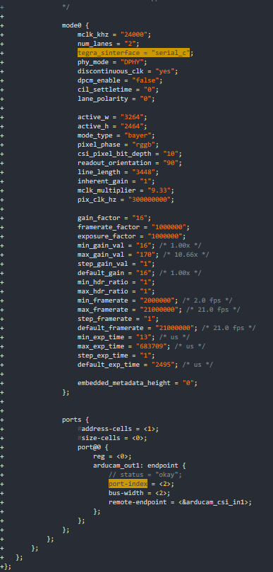

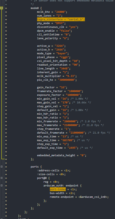

Please find the following driver code where I set the lane-polarity and port-index as explained:
AND
CORRECT??
Thanks a lot for you help!
hello reem.othman,
this only happened on A03.
to simplify,
CAM0 port (J20) used CSIB (i.e. CSI1 in data-sheet) and CAM1 port (J21) used CSIC (i.e. CSI2 in data-sheet), Only x2 lane mode is supported.
your Q1 and Q2 were correct. but Q3 assign to incorrect port-index.
please use port-index=<1> for serial_b, and port-index=<2> for serial_c.

I made all changes and I successfully patched the patch file (driver source code for Ov9782) to the kernel_src follwoing your mentioned steps, but still I wasn’t able to get any data via the CAM0 port!
My question is, do I need to change the port-index to 1 instead of 0 in all the source code as attached in screenshots?? or just specific places?
Here are the instances of the port-index in the source_code file :
hello reem.othman,
this depends-on your real camera connections, default reference driver (i.e. IMX219) it’s using csi-b.
