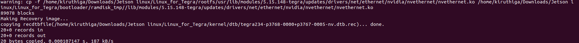

I’m trying to flash the jetson orin nano dev kit with l4t_initrd_flash.sh. I followed the instructions in the quick start - Developer guide ( Quick Start — NVIDIA Jetson Linux Developer Guide 1 documentation ).
The module I’m using is Jetson orin nano 8GB and External storage for flashing is NVMe - 128 GB. I’ve downloaded the BSP and Sample file systems from the DRIVERS section of the recommended page and used for flashing.
My flashing process terminates with the following error.
what could be the possible reason and how to resolve this issue?

Thanks for your response.
I’m using the correct configuration jetson-orin-nano-devkit for flashing. I’ve verified the NVMe detection. I doubt whether I need to use BSP and Sample file system from DRIVERS section or from SOURCES section of the download page?
Also, When I tried with flash.sh, I got the following log that shows flashing has started and it is still running.
What’s the host system distribution and version? Are you trying this from a bare-metal host or a docker container or VM?
The link to the developer guide you posted is for L4T 36.2 but the latest is 36.4.4. Exactly which one are you using? If you 're not using 36.4.4, you should probably download it and follow its instructions from Welcome — NVIDIA Jetson Linux Developer Guide
I don’t remember if 36.2 had tools/l4t_flash_prerequisites.sh but 36.4.4 does. Did you run it?
I’m using ubuntu 20.04 host machine to flash L4T 36.4.4. on the dev kit. The issue seems to be raised due to storage insufficiency in my host machine and it is resolved now. Thanks for your response.
