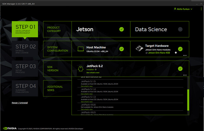

We are using Ubuntu 22.04 and we installed Jetpack 6.2. But when we searched the forum we found content about this camera needing Jetpack 5.1.1 But when we want to install 5.1.1 it is not displayed in SDK Manager. How can we use this camera?
Should have a checkbox to load older JP version.
You can download the JP5.1.1 from below link to manually flash it.
Is there a guide we can follow for manual flashing?

Follow below doc for it.
We wanted to follow this tutorial and set up the camera. But when we changed this field, the image with hdmi went away.

In addition, when we manually install and close it, we cannot connect the screen with HDMI. The screen does not appear. Is the camera not installed with Jetpack 6.2?
