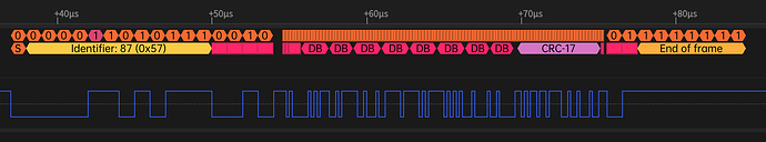

After selecting nominal baudrate as 1M and data baudrate as 5M, and it also outputs the right baudrate by ip -details link show can0. The data section is still outputing at 1M. Below is a figure probing from a logic analyzer whe orin tries to send 007#FFFFFFFFFFFFFFFC.
A FDCAN with 5M baudrate data frame looks like below when probing from a logic analyzer:
As shown, “DB” which is the data, is 5 times shorter than the previous one.
Change TDRC (idk if it’s relevant)
I also found a section in CAN guide here about changing “TDRC”. But upon checking, I do not have this file, as shwon below:
