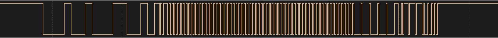

When I try to send a FD frame,
$ cansend can4 123##1aaaaaaaaaaaaaaaaaaaaaaaaaaaaaaaaaa
it is truncated in the Control Field, in the BRS more or less (sniffing with a logic analyzer):
However, in loopback mode on
$ sudo ip link set can4 up type can bitrate 1000000 sample-point 0.6 dbitrate 5000000 dsample-point 0.625 fd on loopback on
the frame is fully and correctly generated:
and if I do not set can5 to loopback mode, it sends ACK! So it is not a matter of my hardware nor the capabilities of the CAN, not even CAN misconfiguration. It seems it is a matter of the Jetson CAN Controller.

My Jetpack is 6.2, Jetson Linux 36.4.3. I have done the test with other transceivers (the recommended WaveShare SN65HVD230 CAN board) and same happens, so it is not a matter of the transceiver.
Only messages in dmesg are
[ +31,188549] mttcan c320000.mttcan can5: entered error warning state
[  +0,000145] mttcan c320000.mttcan can5: entered error passive state
[  +0,000695] mttcan c320000.mttcan can5: entered bus off state
and this is because it expects an ack never received (because the frame is bad), so it keeps retrying (sending bad frames again and again) after entering in error passive state.

I can make an explanation easier for what is going on:
Do this to set up both CANs:
sudo ip link set can4 up type can bitrate 1000000 sample-point 0.6 dbitrate 5000000 dsample-point 0.625 fd on loopback off
sudo ip link set can5 up type can bitrate 1000000 sample-point 0.6 dbitrate 5000000 dsample-point 0.625 fd on loopback on
DMesg are as expected:
[ +19,386157] mttcan c320000.mttcan can5: Bitrate set
[  +0,000181] mttcan_controller_config: ctrlmode 21
[  +0,000029] mttcan c320000.mttcan can5: Bitrate set
[  +0,000065] IPv6: ADDRCONF(NETDEV_CHANGE): can5: link becomes ready
[jun17 10:22] mttcan c310000.mttcan can4: Bitrate set
[  +0,000274] mttcan_controller_config: ctrlmode 20
[  +0,000023] mttcan c310000.mttcan can4: Bitrate set
[  +0,000096] IPv6: ADDRCONF(NETDEV_CHANGE): can4: link becomes ready
Then send a frame from can5 (the one with loopback on) and dump from the other:
$ cansend can5 123##1aaaaaaaaaaaaaaaaaaaaaaaaaaaaaaaaaa
$ candump can4
  can4  123  [20]  AA AA AA AA AA AA AA AA AA AA AA AA AA AA AA AA AA 00 00 00
This setup works. No more dmesg.
Now, do it with both loopback off:
sudo ip link set can4 down
sudo ip link set can5 down
sudo ip link set can5 up type can bitrate 1000000 sample-point 0.6 dbitrate 5000000 dsample-point 0.625 fd on loopback off
And send the same frame:
$ candump can4
Now, can4 receives nothing, and can5 enters error passive:
[jun17 10:30] mttcan c320000.mttcan can5: Bitrate set
[  +0,000500] mttcan_controller_config: ctrlmode 20
[  +0,000393] IPv6: ADDRCONF(NETDEV_CHANGE): can5: link becomes ready
[  +6,598148] mttcan c310000.mttcan can4: Bitrate set
[  +0,000449] mttcan_controller_config: ctrlmode 20
[  +0,000025] mttcan c310000.mttcan can4: Bitrate set
[  +0,000090] IPv6: ADDRCONF(NETDEV_CHANGE): can4: link becomes ready
[ +16,501512] mttcan c310000.mttcan can4: entered error warning state
[  +0,000296] mttcan c320000.mttcan can5: entered error warning state
[  +0,000123] mttcan c320000.mttcan can5: entered error passive state
[  +0,000729] mttcan c320000.mttcan can5: entered bus off state

Have you confirmed that there’s only one 120Ohm resistor as terminator in your CAN setup?
Yes, there is only one 120 Ohm resistor. Are you able to reproduce the error? Because if not, I am starting to think my jetson is somehow broken.
Sorry that I can’t reproduce similar issue on the devkit with CAN-FD data transaction.
Do you have other board hitting the similar issue?
Or the issue is specific to the current board?
We do not have any other board currently, but going to purchase one soon. Can we keep the topic open until I get the new one?
Sure, please also try adding sjw 4 in the command when you are setting up CAN interface to check if it could help.
