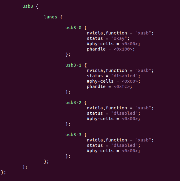

@WayneWWW ,
I have disabled the 3-1 PHY lane, but flashing is still failing. I will share the file name I edited—please confirm if this is the correct place to make the change.
Linux_for_Tegra/source/hardware/nvidia/t23x/nv-public/tegra234-p3768-0000.dtsi
Also, it looks like the changes in this configuration file have been applied to the full dtb.
Do not say something like “it looks like”. Just convert back the dtb that got flashed to the board to dts by using dtc tool and review it.
@WayneWWW ,
I have confirmed already the change has applied in full dtb.
