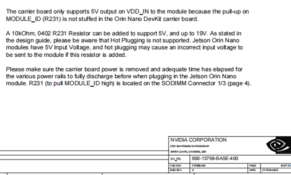

Hello, I am trying to write the system of orin nx module on the official orin nano carrier board with BSP version L4TR35.3.1, and the R231 pulp-up resistor on the carrier board has also been welded, and the SSD used is M.2 aigo P2000 Gen3.0 256GB, but I have tried for many times, but I have not been successful. Waiting for target to boot-up… In this step, tar: Read checkpoint 70000 prompts an unidentified USB device.

According to the schematic diagram provided by the official orin nano board, when the Orin nx module is burned, the power supply is 5V when R231 is not attached, and the power supply is 19V when R231 is attached. When I tried to power the orin nx module 5V, the operating system could not be burned. I tried to write the operating system to the orin nx module with 19V power supply, but the result was still unsuccessful.

Hello, I am very sure that I have tried for many times, both SDK manager and BSP can write normally, and I have tried two versions, Jetpack5.1.1 and Jetpack5.1.2
Then please get a new Orin NX module first.
Ok, thank you very much
