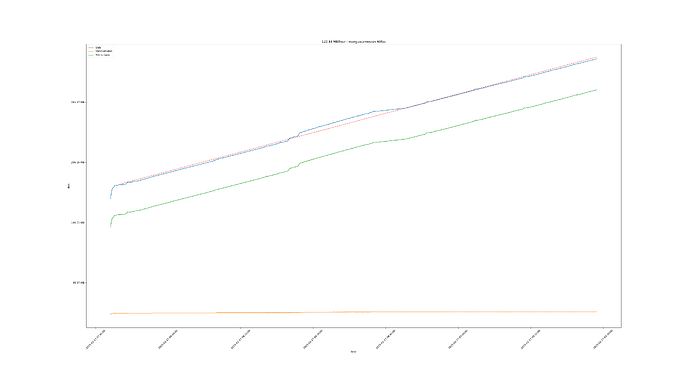

We are experiencing a significant kernel memory leak when using Argus cameras on the platform detailed above.

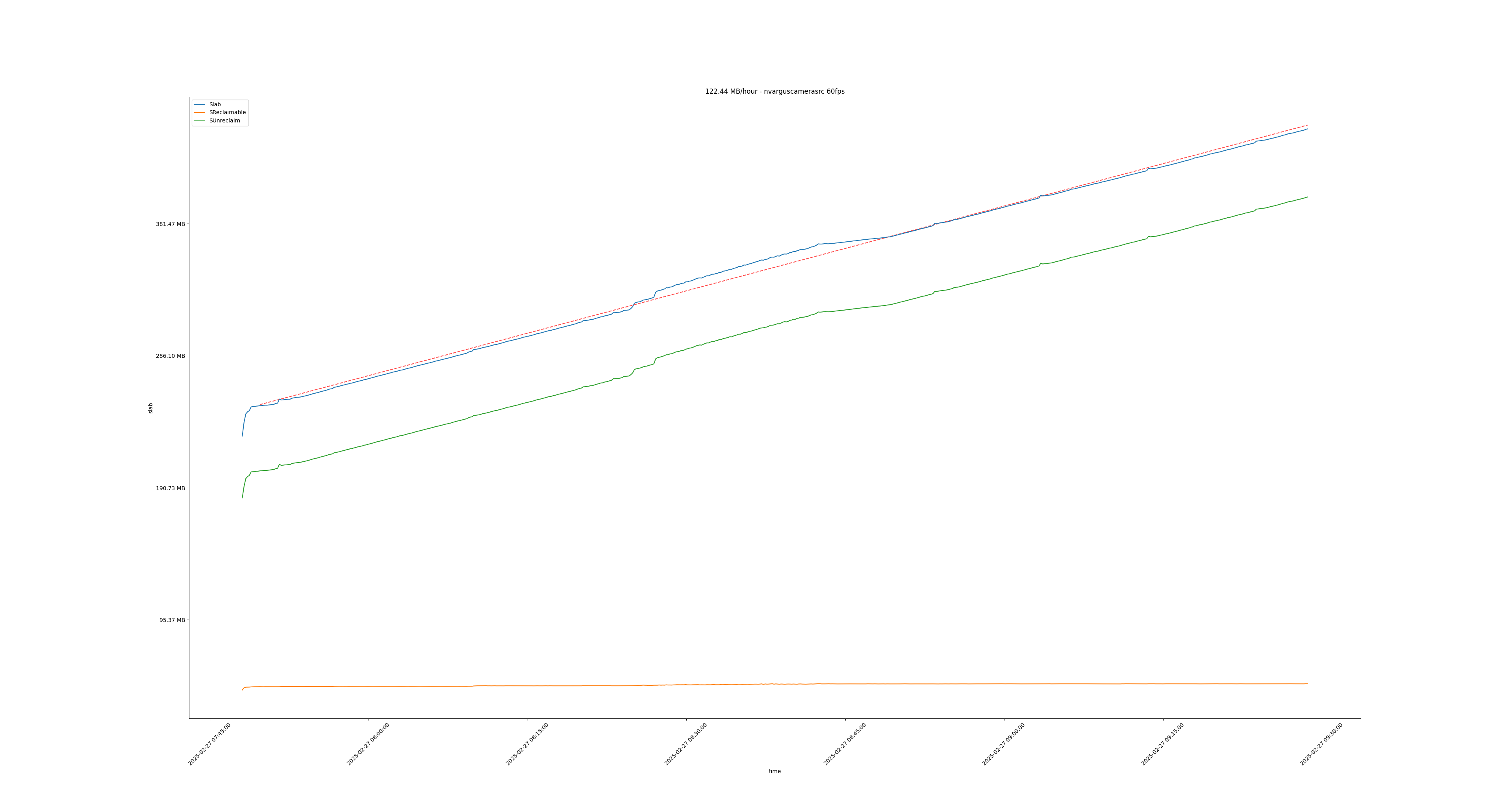

Its rate of growth appears to be dependent on frame rate:
- 122 MB per hour at 60 fps
- 27 MB per hour at 15 fps
which severely limits the up time of applications using the camera on a 4GB Orin Nano.
This can be reproduced with any minimal example consuming images from the camera, for instance:
gst-launch-1.0 nvarguscamerasrc ! fakesink
and observing the Slab memory stats with either /proc/meminfo or slabtop.
The leak seems to be of memory allocated with kmem_cache_alloc in the kmalloc-256 cache each frame, as reported using the kmemleak tool:

Furthermore /proc/meminfo shows this leaked memory is unreclaimable, meaning this memory can only be freed by rebooting the device, as far as I understand if:
Slab: 460280 kB
SReclaimable: 50348 kB
SUnreclaim: 409932 kB
