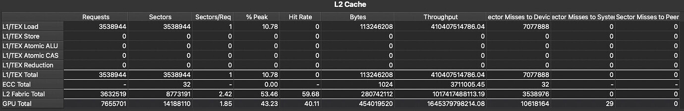

As you can see, there is a large stride between memory access of adjacent threads (1KB) and this gap is larger than the L2 cache line size. I did this intentionally because I did not want this kernel to hit L2 cache. Thus, each memory address is used only once when loading the data. Then I expect the L2 cache hit rate of this kernel to be zero.
However, the profiling result does not support my guess.
read_write_kernel.ncu-rep (1.7 MB)
The L2 cache hit rate is 50% and the troublemaker seems to be the L2 Fabric. As shown below, the request count of L1/TEX load is correct (3538944=216blocks * 1024threads * 16 memory access). Then, what are the requests from L2 Fabric? I know that there may be two partitions of L2 cache and they have to transfer data to each other. But what is the hit rate under this scenario? From my understanding, the requests of GPU total should be 3538944 and the hit rate should be 0.
