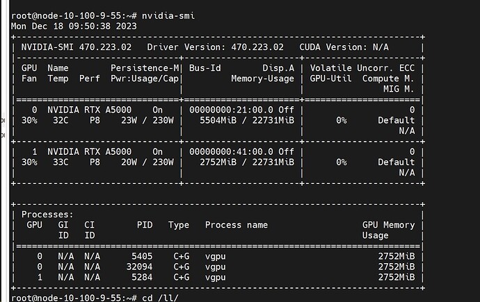

Licensing option not present in Nvidia Control Panel in windows 10 platformat
Options for configuring licensing for a
network-based license server are not available in NVIDIA Control Panel of windows 10 guest vm. I have installed NVIDIA-Linux-x86_64-470.223.02-vgpu-kvm.run on Unbuntu 22.04. I have installed 474.64_grid_win10_win11_server2016_server2019_server2022_64bit_international.exe on windows10 guest vm
The following are infos on guest vm.:
The following are logs on host:
The following is logs of nvidia-smi.exe -q

And what is your issue?
Have you created a client config token for the VM?
Your nvidia-smi output doesn’t contain the required licensing state information.
Please describe in more detail what you are going to achieve. A bunch of screenshots doesn’t really help to get the full picture.
Thanks for your answer.
“And what is your issue?”
I have installed nvidia vgpu drivers, but there is no options for configuring licensing for a
network-based license server in NVIDIA Control Panel.
“Have you created a client config token for the VM?”
I have a client token from cls, and I have copy it to c:\Program Files\NVIDIA Corporation
\vGPU Licensing\ClientConfigToken in VM.
client_configuration_token_12-18-2023-18-38-58.zip (2.0 KB)
The following is nvidia-smi -q >nvidia.log

Thanks for your answers.
I have output from nvdia-smi -q from host pc.
==============NVSMI LOG==============
Timestamp                                 : Tue Dec 19 09:30:11 2023
Driver Version                            : 470.223.02
CUDA Version                              : Not Found
Attached GPUs                             : 2
GPU 00000000:21:00.0
    Product Name                          : NVIDIA RTX A5000
    Product Brand                         : NVIDIA
    Display Mode                          : Enabled
    Display Active                        : Disabled
    Persistence Mode                      : Enabled
    MIG Mode
        Current                           : N/A
        Pending                           : N/A
    Accounting Mode                       : Enabled
    Accounting Mode Buffer Size           : 4000
    Driver Model
        Current                           : N/A
        Pending                           : N/A
    Serial Number                         : 1322021011273
    GPU UUID                              : GPU-155352b9-6b79-78ad-83fb-09af7f018f11
    Minor Number                          : 1
    VBIOS Version                         : 94.02.6D.00.0D
    MultiGPU Board                        : No
    Board ID                              : 0x2100
    GPU Part Number                       : 900-5G132-2200-000
    Module ID                             : 0
    Inforom Version
        Image Version                     : G132.0500.00.01
        OEM Object                        : 2.0
        ECC Object                        : 6.16
        Power Management Object           : N/A
    GPU Operation Mode
        Current                           : N/A
        Pending                           : N/A
    GSP Firmware Version                  : N/A
    GPU Virtualization Mode
        Virtualization Mode               : Host VGPU
        Host VGPU Mode                    : SR-IOV
    IBMNPU
        Relaxed Ordering Mode             : N/A
    PCI
        Bus                               : 0x21
        Device                            : 0x00
        Domain                            : 0x0000
        Device Id                         : 0x223110DE
        Bus Id                            : 00000000:21:00.0
        Sub System Id                     : 0x147E10DE
        GPU Link Info
            PCIe Generation
                Max                       : 4
                Current                   : 1
            Link Width
                Max                       : 16x
                Current                   : 16x
        Bridge Chip
            Type                          : N/A
            Firmware                      : N/A
        Replays Since Reset               : 0
        Replay Number Rollovers           : 0
        Tx Throughput                     : 0 KB/s
        Rx Throughput                     : 0 KB/s
    Fan Speed                             : 30 %
    Performance State                     : P8
    Clocks Throttle Reasons
        Idle                              : Active
        Applications Clocks Setting       : Not Active
        SW Power Cap                      : Not Active
        HW Slowdown                       : Not Active
            HW Thermal Slowdown           : Not Active
            HW Power Brake Slowdown       : Not Active
        Sync Boost                        : Not Active
        SW Thermal Slowdown               : Not Active
        Display Clock Setting             : Not Active
    FB Memory Usage
        Total                             : 22731 MiB
        Used                              : 13760 MiB
        Free                              : 8971 MiB
    BAR1 Memory Usage
        Total                             : 32768 MiB
        Used                              : 1 MiB
        Free                              : 32767 MiB
    Compute Mode                          : Default
    Utilization
        Gpu                               : 0 %
        Memory                            : 0 %
        Encoder                           : 0 %
        Decoder                           : 0 %
    Encoder Stats
        Active Sessions                   : 0
        Average FPS                       : 0
        Average Latency                   : 0
    FBC Stats
        Active Sessions                   : 0
        Average FPS                       : 0
        Average Latency                   : 0
    Ecc Mode
        Current                           : Enabled
        Pending                           : Enabled
    ECC Errors
        Volatile
            SRAM Correctable              : 0
            SRAM Uncorrectable            : 0
            DRAM Correctable              : 0
            DRAM Uncorrectable            : 0
        Aggregate
    Retired Pages
        Single Bit ECC                    : N/A
        Double Bit ECC                    : N/A
        Pending Page Blacklist            : N/A
    Remapped Rows
        Correctable Error                 : 0
        Uncorrectable Error               : 0
        Pending                           : No
        Remapping Failure Occurred        : No
        Bank Remap Availability Histogram
            Max                           : 192 bank(s)
            High                          : 0 bank(s)
            Partial                       : 0 bank(s)
            Low                           : 0 bank(s)
            None                          : 0 bank(s)
    Temperature
        GPU Current Temp                  : 32 C
        GPU Shutdown Temp                 : 98 C
        GPU Slowdown Temp                 : 95 C
        GPU Max Operating Temp            : 90 C
        GPU Target Temperature            : 84 C
        Memory Current Temp               : N/A
        Memory Max Operating Temp         : N/A
    Power Readings
        Power Management                  : Supported
        Power Draw                        : 23.12 W
        Power Limit                       : 230.00 W
        Default Power Limit               : 230.00 W
        Enforced Power Limit              : 230.00 W
        Min Power Limit                   : 100.00 W
        Max Power Limit                   : 230.00 W
    Clocks
        Graphics                          : 210 MHz
        SM                                : 210 MHz
        Memory                            : 405 MHz
        Video                             : 555 MHz
    Applications Clocks
        Graphics                          : 1695 MHz
        Memory                            : 8001 MHz
    Default Applications Clocks
        Graphics                          : 1695 MHz
        Memory                            : 8001 MHz
    Max Clocks
        Graphics                          : 2100 MHz
        SM                                : 2100 MHz
        Memory                            : 8001 MHz
        Video                             : 1950 MHz
    Max Customer Boost Clocks
        Graphics                          : N/A
    Clock Policy
        Auto Boost                        : N/A
        Auto Boost Default                : N/A
    Voltage
        Graphics                          : 681.250 mV
    Processes
        GPU instance ID                   : N/A
        Compute instance ID               : N/A
        Process ID                        : 7863
            Type                          : C+G
            Used GPU Memory               : 2752 MiB
        Process ID                        : 7935
            Type                          : C+G
        Process ID                        : 8011
            Type                          : C+G
        Process ID                        : 8095
            Type                          : C+G
        Process ID                        : 8295
            Type                          : C+G
GPU 00000000:41:00.0
    MIG Mode
        Current                           : N/A
        Pending                           : N/A
    Driver Model
        Current                           : N/A
        Pending                           : N/A
    Serial Number                         : 1322721064069
    GPU UUID                              : GPU-47ec8319-e85c-20a7-c189-9f02cc1d4628
    Minor Number                          : 0
    MultiGPU Board                        : No
    Board ID                              : 0x4100
    Module ID                             : 0
    Inforom Version
        OEM Object                        : 2.0
        ECC Object                        : 6.16
    GPU Operation Mode
        Current                           : N/A
        Pending                           : N/A
    IBMNPU
    PCI
        Bus                               : 0x41
        Device                            : 0x00
        Domain                            : 0x0000
        Bus Id                            : 00000000:41:00.0
        GPU Link Info
            PCIe Generation
                Max                       : 4
                Current                   : 1
            Link Width
                Max                       : 16x
                Current                   : 16x
        Bridge Chip
            Type                          : N/A
            Firmware                      : N/A
    Fan Speed                             : 30 %
        Idle                              : Active
    FB Memory Usage
        Total                             : 22731 MiB
        Used                              : 8256 MiB
        Free                              : 14475 MiB
    BAR1 Memory Usage
        Total                             : 32768 MiB
        Used                              : 1 MiB
        Free                              : 32767 MiB
    Utilization
        Gpu                               : 0 %
        Memory                            : 0 %
        Encoder                           : 0 %
        Decoder                           : 0 %
    Encoder Stats
        Active Sessions                   : 0
        Average FPS                       : 0
        Average Latency                   : 0
    FBC Stats
        Active Sessions                   : 0
        Average FPS                       : 0
        Average Latency                   : 0
    Ecc Mode
        Current                           : Enabled
        Pending                           : Enabled
    ECC Errors
        Volatile
        Aggregate
    Retired Pages
    Remapped Rows
        Pending                           : No
            Max                           : 192 bank(s)
            High                          : 0 bank(s)
            Partial                       : 0 bank(s)
            Low                           : 0 bank(s)
            None                          : 0 bank(s)
    Temperature
        GPU Current Temp                  : 33 C
    Power Readings
        Power Draw                        : 20.57 W
    Clocks
        Graphics                          : 210 MHz
        SM                                : 210 MHz
        Memory                            : 405 MHz
        Video                             : 555 MHz
    Applications Clocks
        Graphics                          : 1695 MHz
        Memory                            : 8001 MHz
        Graphics                          : 1695 MHz
        Memory                            : 8001 MHz
    Max Clocks
        Graphics                          : 2100 MHz
        SM                                : 2100 MHz
        Memory                            : 8001 MHz
        Video                             : 1950 MHz
        Graphics                          : N/A
    Clock Policy
        Auto Boost                        : N/A
    Voltage
        Graphics                          : 675.000 mV
    Processes
        Process ID                        : 7725
            Type                          : C+G
        Process ID                        : 7789
            Type                          : C+G
        Process ID                        : 8184
            Type                          : C+G
The “displaymodeselector --gpumode physical_display_disabled” command has been run in our host pc.
