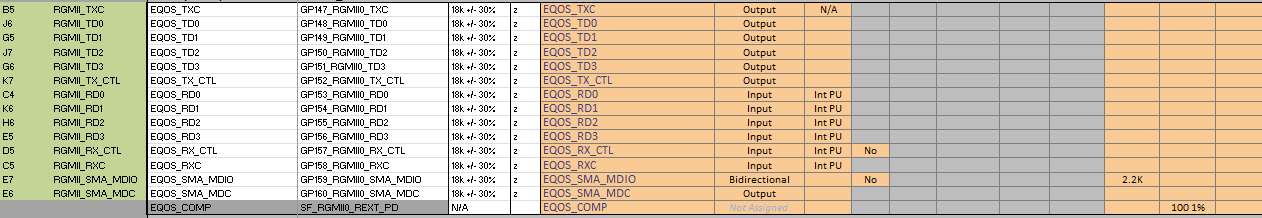

Hi, I am attempting to bring up an 88E1512 phy on an AGX Orin. I believe I have followed the adaptation guide appropriately, but I am still running into issues. My pinmux has been set to match the adaptation guide.
I have confirmed that running ‘ifconfig eth0 down’ triggers the reset pin on the phy using an oscope and, similarly, ‘ifconfig eth0 up’ drives the reset line high. Similarly, I have used mdio-tool to force the interrupt line which toggles and releases with the write to page 3, register 18 bit 15.
ODMDATA has been set in my conf accoring to the adaptation guide. I have not yet implemented the pipe2uphy devicetree entries to fully move to configuration #2 – some help with that would be appreciated.
I have disabled the MGBE interfaces.

EQOS /
ethernet@2310000 {
status = “okay”;
nvidia,mac-addr-idx = <0>;
nvidia,phy-reset-gpio = <&tegra_main_gpio TEGRA234_MAIN_GPIO(G, 5) 0>;
phy-mode = “rgmii-id”;
phy-handle = <&phy>;
nvidia,max-platform-mtu= <8000>;
nvidia,pause_frames = <0>; /
0=enable, 1=disable */
// /delete-node/ fixed-link;
	mdio {
		compatible = "nvidia,eqos-mdio";
		#address-cells = <1>;
		#size-cells = <0>;
		phy: phy@0 {
			reg = <0>;
                    	nvidia,phy-rst-pdelay-msec = <224>; /* msec */
                    	nvidia,phy-rst-duration-usec = <10000>; /* usec */
                    	interrupt-parent = <&tegra_main_gpio>;
                    	interrupts = <TEGRA234_MAIN_GPIO(G, 4) IRQ_TYPE_LEVEL_LOW>;
                    	marvell,copper-mode;
                    	/* Setup LED[2] as interrupt pin (active low) */
			marvell,reg-init = <0x03 0x12 0x7fff 0x880>;

Just to clarify. Is there any actual functional problem here or you are just asking about why there is a log printed?
The phy is not communicating. Ifconfig eth0 up is not giving me a connection.
As this thing has been checked many times. Please directly check this post.
  1. ODMdata is not related to RGMII.
  2. Make sure the pinmux and gpio are correctly configured and flashed to the board.

I reflashed my board with this change and don’t see any difference in behavior in the ethernet. Are there additional changes that need to be made? I don’t see any other aspects of this post that differ from mine with the exception of removing the marvell,copper-mode and initial register config from the dts.
From what I can tell, both the pinmux and GPIO appear to be flashed. Do you have any specific tests you could recommend to verify?
I’m still ending up in the exact same situation as before.
For the specific sections you quoted, I did change the reg address from 1 to 0 and verified that was correct using mdio-tool reads/writes.
