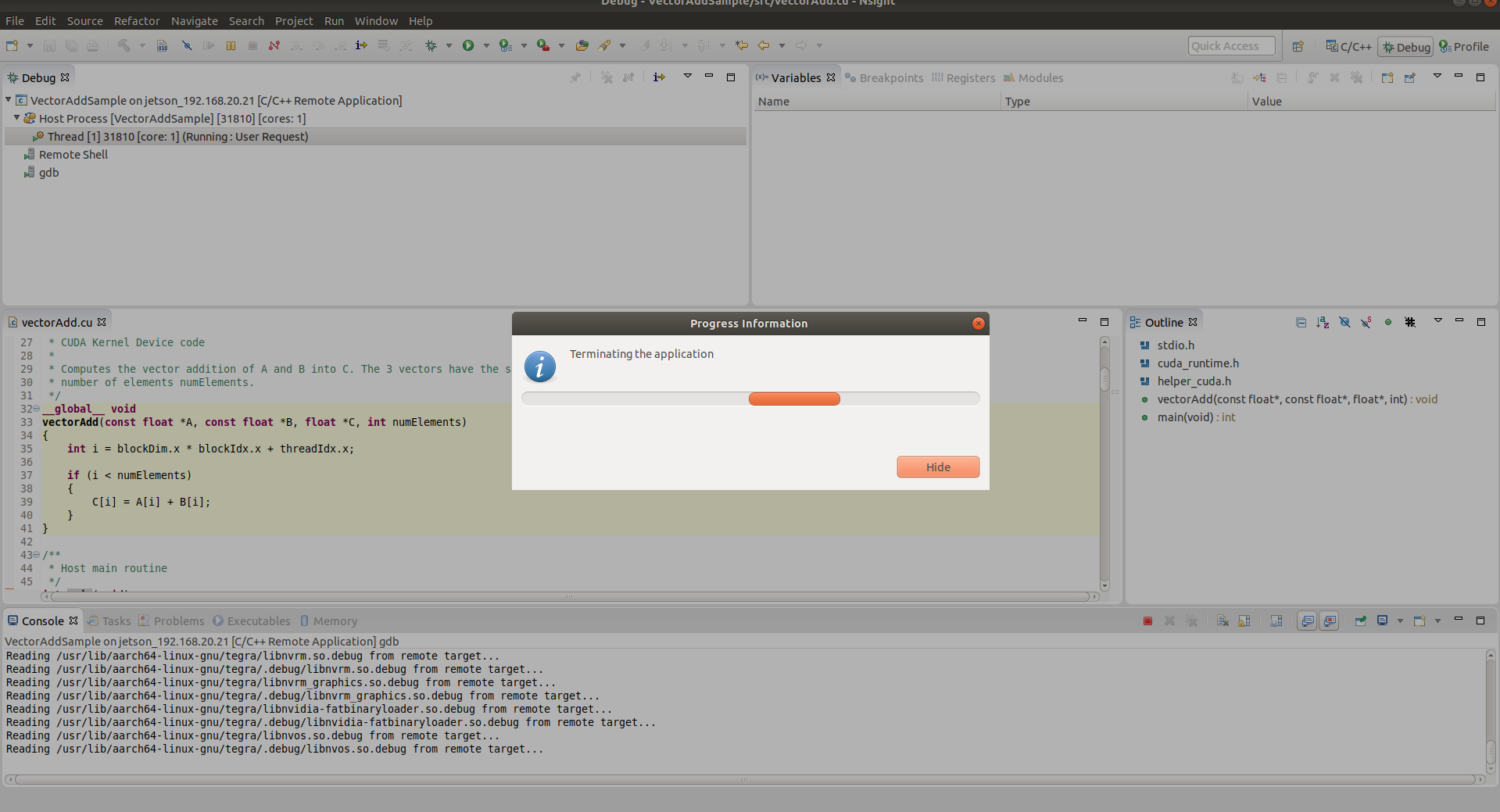

YES.
Debugger
Coalescing of the CUDA commands output is off.
warning: "remote:" is deprecated, use "target:" instead.
warning: sysroot set to "target://".
Reading /lib/ld-linux-aarch64.so.1 from remote target...
warning: File transfers from remote targets can be slow. Use "set sysroot" to access files locally instead.
Reading /lib/ld-2.27.so from remote target...
Reading /lib/.debug/ld-2.27.so from remote target...
0x0000007fb7fd31c0 in ?? () from target:/lib/ld-linux-aarch64.so.1
$1 = 0xff
The target endianness is set automatically (currently little endian)
Reading /lib/aarch64-linux-gnu/librt.so.1 from remote target...
Reading /lib/aarch64-linux-gnu/libpthread.so.0 from remote target...
Reading /lib/aarch64-linux-gnu/libdl.so.2 from remote target...
Reading /usr/lib/aarch64-linux-gnu/libstdc++.so.6 from remote target...
Reading /lib/aarch64-linux-gnu/libgcc_s.so.1 from remote target...
Reading /lib/aarch64-linux-gnu/libc.so.6 from remote target...
Reading /lib/aarch64-linux-gnu/libm.so.6 from remote target...
Reading /lib/aarch64-linux-gnu/librt-2.27.so from remote target...
Reading /lib/aarch64-linux-gnu/.debug/librt-2.27.so from remote target...
Reading /lib/aarch64-linux-gnu/47f37309461cc15fb1915bc198d718017a1f87.debug from remote target...
Reading /lib/aarch64-linux-gnu/.debug/47f37309461cc15fb1915bc198d718017a1f87.debug from remote target...
Reading /lib/aarch64-linux-gnu/libdl-2.27.so from remote target...
Reading /lib/aarch64-linux-gnu/.debug/libdl-2.27.so from remote target...
Reading /usr/lib/aarch64-linux-gnu/d7646e96801c7eed3642d3c10e301e0f3ea553.debug from remote target...
Reading /usr/lib/aarch64-linux-gnu/.debug/d7646e96801c7eed3642d3c10e301e0f3ea553.debug from remote target...
Reading /lib/aarch64-linux-gnu/4bfa7077953acb0e38a1039923ecb5fe9f6a62.debug from remote target...
Reading /lib/aarch64-linux-gnu/.debug/4bfa7077953acb0e38a1039923ecb5fe9f6a62.debug from remote target...
Reading /lib/aarch64-linux-gnu/libc-2.27.so from remote target...
Reading /lib/aarch64-linux-gnu/.debug/libc-2.27.so from remote target...
Reading /lib/aarch64-linux-gnu/libm-2.27.so from remote target...
Reading /lib/aarch64-linux-gnu/.debug/libm-2.27.so from remote target...
Temporary breakpoint 2, main () at ../src/vectorAdd.cu:48
48 ../src/vectorAdd.cu: No such file or directory.
Breakpoint 1, main () at ../src/vectorAdd.cu:58
58 in ../src/vectorAdd.cu
Reading /usr/lib/aarch64-linux-gnu/tegra/libcuda.so.1 from remote target...
Reading /usr/lib/aarch64-linux-gnu/tegra/libnvrm_gpu.so from remote target...
Reading /usr/lib/aarch64-linux-gnu/tegra/libnvrm.so from remote target...
Reading /usr/lib/aarch64-linux-gnu/tegra/libnvrm_graphics.so from remote target...
Reading /usr/lib/aarch64-linux-gnu/tegra/libnvidia-fatbinaryloader.so.32.3.1 from remote target...
Reading /usr/lib/aarch64-linux-gnu/tegra/libnvos.so from remote target...
Reading /usr/lib/aarch64-linux-gnu/tegra/libcuda.so.1.1.debug from remote target...
Reading /usr/lib/aarch64-linux-gnu/tegra/.debug/libcuda.so.1.1.debug from remote target...
Reading /usr/lib/aarch64-linux-gnu/tegra/libnvrm_gpu.so.debug from remote target...
Reading /usr/lib/aarch64-linux-gnu/tegra/.debug/libnvrm_gpu.so.debug from remote target...
Reading /usr/lib/aarch64-linux-gnu/tegra/libnvrm.so.debug from remote target...
Reading /usr/lib/aarch64-linux-gnu/tegra/.debug/libnvrm.so.debug from remote target...
Reading /usr/lib/aarch64-linux-gnu/tegra/libnvrm_graphics.so.debug from remote target...
Reading /usr/lib/aarch64-linux-gnu/tegra/.debug/libnvrm_graphics.so.debug from remote target...
Reading /usr/lib/aarch64-linux-gnu/tegra/libnvidia-fatbinaryloader.so.debug from remote target...
Reading /usr/lib/aarch64-linux-gnu/tegra/.debug/libnvidia-fatbinaryloader.so.debug from remote target...
Reading /usr/lib/aarch64-linux-gnu/tegra/libnvos.so.debug from remote target...
Reading /usr/lib/aarch64-linux-gnu/tegra/.debug/libnvos.so.debug from remote target...
[Inferior 1 (process 10721) exited normally]
Quit

When I launch the profiler, I have nothing :
Moreother, the debugger doesn’t work for the GPU.
For example, when I resume, I can’t stop the debugging. Nsight is blocked on this page :
Moreother, I have the following lines :
warning: “remote:” is deprecated, use “target:” instead.
warning: sysroot set to “target://”.
Reading /lib/ld-linux-aarch64.so.1 from remote target…
warning: File transfers from remote targets can be slow. Use “set sysroot” to access files locally instead.
Thanks a lot for your help !
please someone help me
