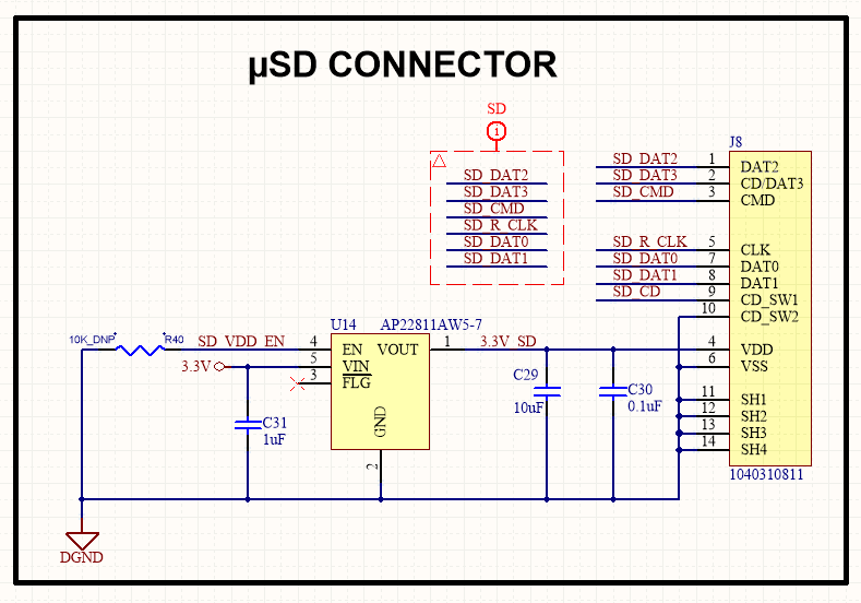

Here are the schematics.
SOM SD pins:
SOM_SD_pins
SOM GPIO for micro-SD:
TVS protection:
R37 is not placed (internal pull-up expected). R36 protects the SOM in case GPIO07 is configured as output for other purposes and the card is inserted, shouldn’t disturb card detect functionality with a strong internal pull-up.
Micro-SD card socket + load switch:
Please add cd-gpios back first.

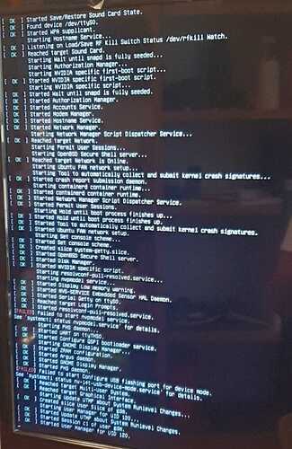

I followed the steps and flashed the board again. I set the initial configurations (language, user, password,…) but then the board is not working. It’s connected to a monitor and when it’s booting three errors appear, ‘Failed to start Load Kernel Modules’, ‘Failed to start nvpmodel service’, and ‘Failed to start Configure USB flashing port for device mode…’
It is time to learn how to use the uart console to debug but not the monitor.
https://elinux.org/Jetson/General_debug
At the end I’m not able to enter the login.

Why? The password and account are wrong?
I’m not sure, I’m trying to type the password but it doesn’t type anything.
You probably don’t connect the UART pin correctly…
I built the kernel again and I flashed the board, now it’s working. I guess now I have to modify the dts file to activate the pins for the micro-sd card?
