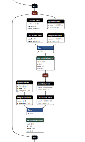

One thing we’ve observed is the you model graph doesn’t follow the full recommendations from TensorRT. Like the residual branch in the model has no additional QDQ pair. For example a residual branch in the onnx model graph looks like
whereas TRT recommendation would look like
Basically the identity branch should have a QDQ pair. Otherwise, this might lead to suboptimal fusions which can leave dangling Q/DQ nodes which can be expensive as explained in the documentation : Developer Guide :: NVIDIA Deep Learning TensorRT Documentation

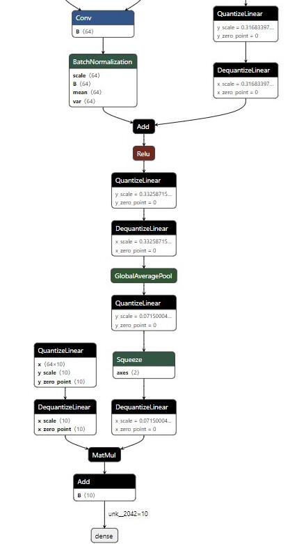

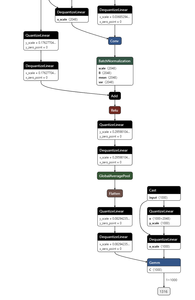

This is your onnx model’s graph around the global-average-pooling operation:
In this graph the matmul operation is performed in float. Add Q/DQ in front of the mamul ( StatefulPartitionedCall/model/dense/MatMul ) input and weights and you get int8 matmul.
However, the GAP operates in float so the output of the Conv ( StatefulPartitionedCall/model/quant_conv2d_56/BiasAdd ) is also in float and you have a dangling DQ ( DequantLinearNode__1173 ).
Add another Q/DQ pair before the GAP node. The Q node from this new pair of Q/DQ propagates backward over the ReLU and fuses with the Conv ( StatefulPartitionedCall/model/quant_conv2d_56/BiasAdd ). Now its output is int8.
It should look like this (from our reference model):
Thank you.
Thank you, this is what I got after adding the require QDQ ops for the final dense layer and the global_average_pooling layer.
For some reason, tf2onnx keeps adding a squeeze layer between the Q and DQ ops for the final dense layer, does it still result in optimal fusion? I could use graph surgery to move it before the Q op, is it required?
