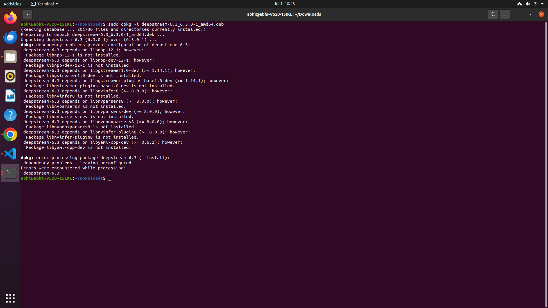

ModuleNotFoundError: No module named 'common.is_aarch_64'

I need immediate assistance to resolve this as soon as possible. This is a very urgent project
Extra Info :
Setup Information:
Hardware Platform**: x86_64 (Lenovo V520), NOT Jetson
GPU: NVIDIA GeForce RTX 3050
Operating System: Ubuntu 20.04
NVIDIA Driver Version: 535.230.02
CUDA Version: 12.2 (per nvidia-smi)
DeepStream Version: 6.3
TensorRT Version: As bundled in DeepStream 6.3 Docker
Docker Image: nvcr.io/nvidia/deepstream:6.3-gc-triton-devel
Issue Type: Runtime Errors / Missing Module (common.is_aarch_64)
JetPack Version: N/A (NOT on Jetson)
cd /opt/nvidia/deepstream/deepstream
./user_deepstream_python_apps_install.sh -b -r v1.1.8
common.is_aarch_64 is located at opt/nvidia/deepstream/deepstream/sources/deepstream_python_apps/apps/common/is_aarch_64.py.
DS-6.3 needs to pull tag v1.1.8. It is recommended that you use the latest nvcr.io/nvidia/deepstream:7.1-gc-triton-devel, which corresponds to the master branch

could You please instruct me on this problem also this is very urgent base
Please refer to my tips above to install pyds
docker run --gpus all -it --rm --network=host --privileged -v /tmp/.X11-unix:/tmp/.X11-unix -e DISPLAY=$DISPLAY -w /opt/nvidia/deepstream/deepstream nvcr.io/nvidia/deepstream:6.3-gc-triton-devel

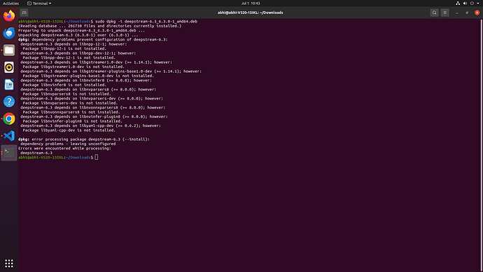

I need to setup in my local machine whenever Im trying to run this then this is the error im still facing
Please open a new topic.
For DS-6.3
