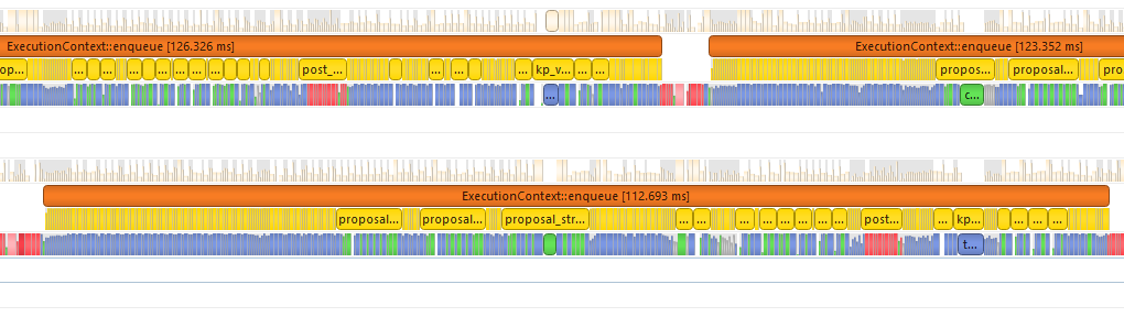

Hello @SivaRamaKrishnaNV @VickNV @kayccc Finally I am able to profile GPU performance using nsight system with drive OS 5.2.6 and we can finally continue this topic now.
I first run one thread with TensorRT (separate execution context, separate cuda stream) with 14ms.
Then I add a second thread to the process with TensorRT (separate execution context and cuda stream), the time increase to 112ms
The zoom-out graph:
We can clearly see that each tensorRT kernel launch (inside the enqueue) will need a pthread_mutex_lock, which is the main reason to slow down the latency. Apparently this is far from optimized. This indicates that any time only one sub-kernel is running since it needs to gain the lock. What would be the correct way to do this?

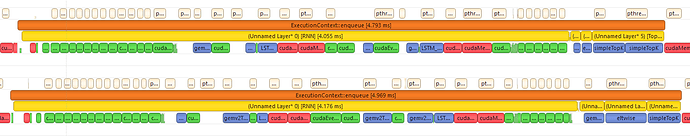

@VickNV I tried the sample code sampleCharRNN and add a simple multithread tests. The performance for 1 thread, 2 threads and 5 threads. I observed that synchronization is needed when multiple tensorRT are running. Each pthread_mutex_lock will increase the latency. But the sample has much less synchronization than in our software, so the performance degradation is not significant.
Single thread (zoomed for one single kernel launch)
Two threaded (zommed for the same kernel launch)
from 1ms (single) to 4.9ms (two threads).
